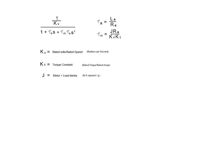

Which transfer function are you referring to? The motor or some other part of the block diagram?
For the motor there is a fairly rigorous transfer function already developed in which the key components are the volts per radian per second, the armature time constant and the mechanical time constant. This would be used if you are directly applying the voltage to the motor.
Another approach is to treat the motor as a current to torque transducer and feed it from a current source which is inside a speed control loop. Each has its appropriate application.

The Transfer Function I am referring to is this one:
![](http://This PC/Desktop/Uploads/DC Motor Transfer Function.jpg)
Attached is a more usual dc motor transfer function which takes into account the CEMF feedback inherent in any dc motor. As you can see the denominator is a quadratic so has 2 time constants which may, or may not be oscillatory. If you must design for a very fast regulator this could cause problems. If you can get away with a slow regulator you can always slug it down till the motor time constants are out of the way.
Understand though that the response of the motor to a change in voltage is a function of both motor and load inertia so anything you measure in a physical experiment will depend on the load inertia which may very well be different from the inertia in your application.
In your physical measurement be sure that you keep the voltage step very small so that you do not run into any sort of current limit of the power supply.
What are you using as a power supply--pure dc, single phase rectified dc, 3 phase rectified dc? With single phase rectified dc you will get discontinuous current which introduces another complication.
