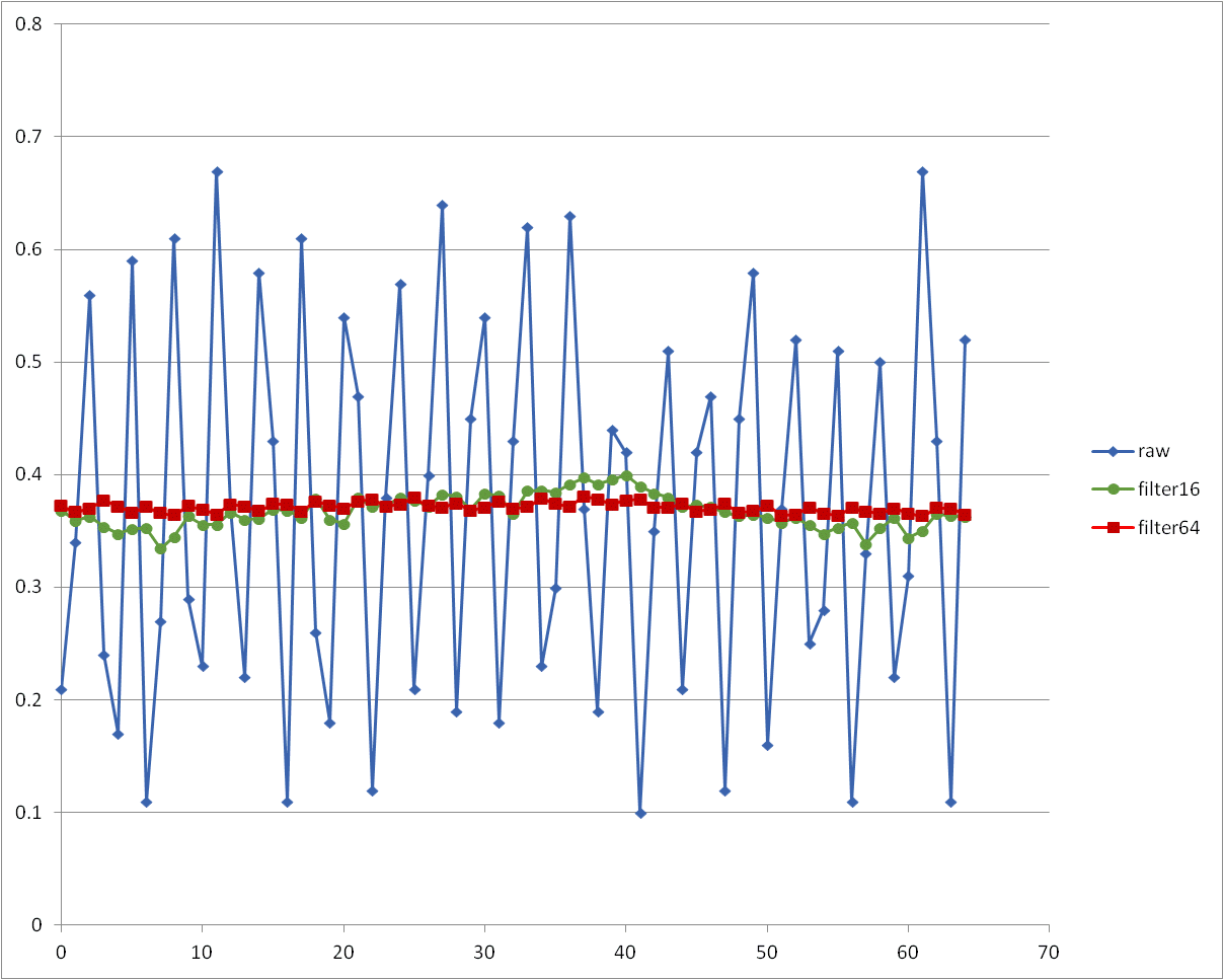

I’m a student on a team developing this project. We are attempting to make a balancing system(by reaction wheel) with current and angle PID control. The whole circuit consists of dc motor(24V, 300w), power supply(up to 30A), current sensor(ina260, up to 15A) and mpu6050(for angle). The process of the system is that angle PID control leads the amount of required current(in the form of duty rate for PWM in Arduino) and it passes current PID control to generate the amount of required torque (to keep it from overcurrent).

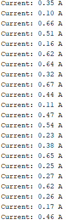

Now I am working on the current part. To collect current data, i install a current sensor(ina260) in dc motor + line. But the problem is that the current data should be continuous but the motor is controlled by PWM in the motor driver and so, the data has so many noises followed by the PWM signals( i checked it by plotting on PC). I previous used Acs 758 analog current sensor but I failed to manage this problem)
Is there a good way to filter the current data nicely?

[Plotted current data]
(true current value = 0.478A)

Welcome, this is an interesting and perplexing problem. I will take a SWAG: The only way you can get a good current value is to read the peak current, time your read when the PWM is on. This is very hard to do with the Arduino, You can use a shunt and a low pass filter in the analog domain and achieve close results. Others will also give you some good suggestions.
Take the signal you get and smooth it.
There are two ways to do this
  1. use an RC filter from the sensor into the analogue reading input.
  2. take a running average over a number of samples.

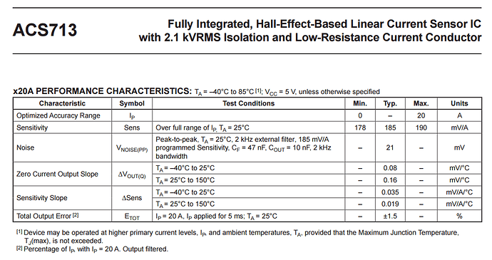

Second, according to datasheet i need Cf(47nF) and Cout(10nF)
Third, then does my current sensing circuit seem to be (Cf = 47nF / Cout = 10nF) like this?
below is typical application datasheet suggests

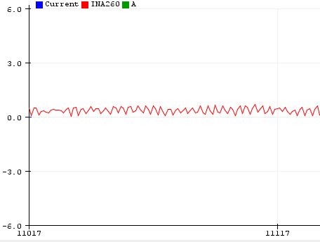

and I plotted the sensing data
(ture current value = 0.478A)
I would much appreciate your further advice!

47nF sounds small for a PWM frequency of 2kHz. 2kHz means a period of 500uS, so if you want the RC constant to approximate this, you'd need something like 220nF instead of 47nF (datasheet page 9 bottom left). In fact I'd suggest sampling across more than a single period and use a capacitor of e.g. 470nF.
I personally don't use a capacitor on the output as it offers no benefit over the filter capacitor that this device can use; in fact, it would only degrade performance (see page 12).

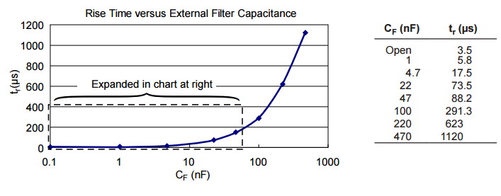

Then, I'd like to make a circuit like this and choose to prefer cap by the datasheet. is that correct?
[Circuit]
[datasheet]
and

From your data it looks as if simple filtering with a small capacitor as per your circuit above, and averaging repeated measurements will give you a good result.
I'd try to check that but you have posted your readins as an image - can you post them as text?

As you would expect your data shows cyclical variation. I've implemented a simple digital filter (attached) that shows the data converges to a value of around 0.38
excel spreadsheet attached here
ina260_current data.zip (17.4 KB)
Its no surprise that the measurement differs from your "true" value of 0.478 (how did you measure that?)
as you will be aware there are different ways of representing the value of an ac parameter - and your signal is neither a simple dc value nor a simple ac waveform.
Also using a filter (of any type) will delay the availability of the reading which will have an effect on how you implement PID control.

As you can see, my signal has PWM noise I guess. (That's why it creates huge oscillations though DC)
And Generated delay when I put a filter on the sensor is one of my biggest worries too.
But in fact, i have no idea to deal with it well....
You may wish to look at an analog strategy as described here, followed by a synchronous detector. (AKA lock in amplifier) - but you can easily build such a device,with a few components - you dont need to buy one.

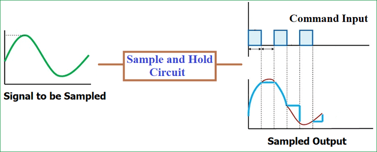

or use a sample & hold op amp circuit
https://www.analog.com/media/en/technical-documentation/data-sheets/lt0198.pdf
Some observations:
For good current control a PWM rate of ideally 10kHz or so is a good start, and you should synchronize the measurement of the current with the PWM cycle. The higher
frequency reduces the current ripple, and synchronization should remove the ripple from appearing in the measurements anyway.
Do not low pass filter the current signal. The feedback loop is going to be destabilized if you do this. Low pass filtering introduces delay and delay is the enemy of stability. This is also a reason for high speed sampling of current - reduce any latency in measurement.
Standard approaches to motor control use an inner high-speed current control loop, and the other control loops just set the set-point of the current loop to achieve their output. Outer loops can run slower, perhaps 1kHz, as they only have to deal with mechanical time-constants which are much slower than the electrical time constant of a motor(*).
Say you run at 3kHz as your code suggests, I'd sample in an ISR for timer1 overflow and run the inner PID loop entirely in that ISR.
