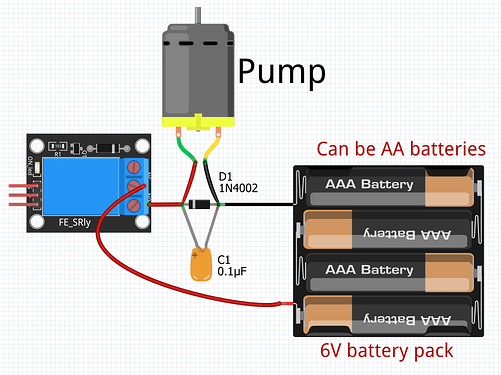

Hello, as the topic states, I have a setup where my arduino is connected to a 5v relay module which is connected to a DC water pump and a 9V battery. The relay, motor, and battery all are working fine while testing individually but as soon I connect the relay with the motor, the motor starts for a few second and then stops the relay module and restarts the whole arduino sketch. I cannot understand the root cause but found out from the internet that it might be a noise coming from the motor. How can I reduce the noise, what devices can I use? Can someone help me here? I would appreciate it. I have attached the circuit diagram too for reference.

Yes, many people have had that problem. You need to put a 0.1uF capacitor and a 1N4007 diode across the motor.
Also make sure that the pump wires are NOT near any other components.

If it has to be cheap, then use AA alkaline batteries.
If it has to be eco-friendly then use recharables.

9V is too much. See post #4
