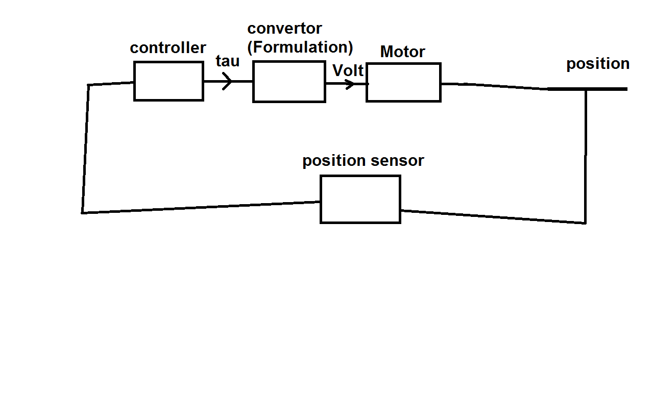

ok I will edit my question
I have the feedback loop controller , but the input signal is torque and in the real experiment the torque must be convert to voltage and the relation is that formula and the dc motor has mechanical friction which assumed as dead-zone
Draw the block diagram.
The above sentence has no relationship to the block diagram you posted, in which the input signal (not shown) and feedback are position.
It would help if you spent a few moments describing the project on which you are actually working, possibly being "the real experiment".
The "dead zone" is the frictional loss, its a torque, not a voltage, and its sign depends on the sign of omega, so you'd split the equation into two versions depending on the sign of omega. Solid friction is fairly close to being constant (independent of speed), but this is
only a first-order approximation.
V = k * omega + R/k (tau + 0.1), omega > 0
= k * omega + R/k (tau - 0.1), omega < 0
(although I might have gotten my sings wrong!)
