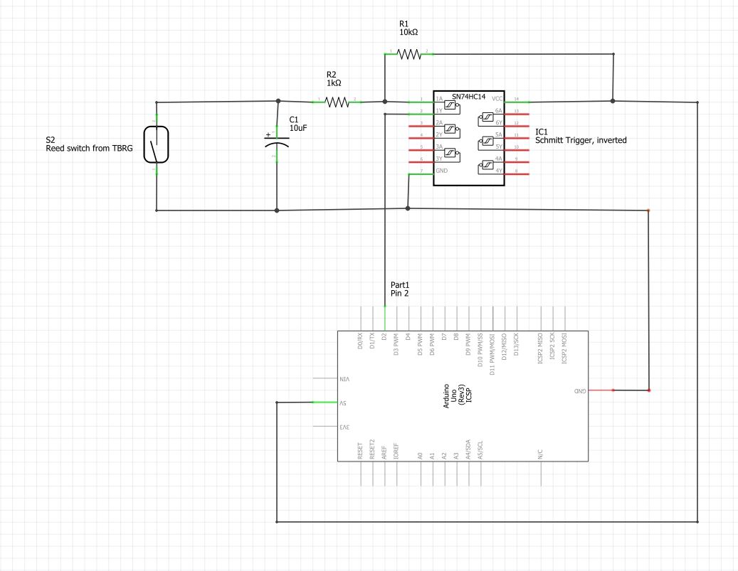

Currently I'm interfacing a Tipping Bucket Rain Gauge (TBRG) to an Arduino Uno.
The TBRG, when it tips, swings a magnet in front of a reed switch which then momentarily closes and pulls the line LOW.
I am using a traditional de-bouncing circuit that is attached to a 74HC14 (Inverted Schmitt Trigger). The output of the 74HC14, which is inverted, is connected to pin 2 of the UNO. This pin is monitored by an interrupt which starts the TBRG function. Every tip detected is then added to the counter which is then transmitted to home base via an nRF24L01.
The de-bouncing circuit has a capacitor of 10 uF and a resistor of 1 kiloOhm. This should give me a R/C time delay of 10 milliseconds. The interrupt also creates a 100 milliseconds delay. The TBRG tips at a maximum rate of 1 Hz, so, plenty of time between tips.
So basically I've got a hardware de-bounce circuit and a software de-bounce routine.
The problem:
This system runs like a dream. However, now and then and without any changes, the output of the Schmitt Trigger stays HIGH all the time! I have tried removing the capacitor, as I thought it stayed saturated when switching too fast, but to no avail.
I have attached my schematic of the circuit to this posting.

Shorting a 10uF cap with your switch may not be the root of your problem...
...but it probably isn't the best practice.
Try this:
From this page.
Hi Dave,
Well spotted!. However, to build my case for this forum I hastily drew up the schematic and unfortunately I put the capacitor in the wrong spot.
In my real life application I have the capacitor of 10 uF between the 10k resistor and input pin 1 of the Schmitt Trigger.
My apologies for that.
Nevertheless this could be useful information for others as it shows how critical it is to put the components in the correct place.
Thanks for the link about the de-bouncing. In return I've bumped up your karma.
Cheers,
Luc

R1 is the timing capacitor, not R2. Make R1 1k, R2 100 ohms.

Thanks MarkT!
I will change the values of the resistors as per your suggestions. I will do that tonight (after I'm back from work).
Great feedback, thanks!
