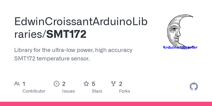

I think you should use a real library that uses real hardware timers, using micros() does not have sufficent resolution.
You are perfectly right. Using a proper library will most likely increase the accurazy. Using micros() is the maximum of my knowledge.
Opening the link You gave me I still don't know how to proceed. Too much that I don't understand.
Well, then there is no better time to learn than right now. Libraries are a key feature of Arduino and you needn’t be attempting recreating things from scratch that have already been created for you.
It’s not at all difficult and you probably know how to do each step individually, you just have to know the proper order and locations where to find and place things.
Please read over the instructions in the link below and post a question when and if you get stuck, include which operating system and version you’re running.
Thanks! I wonder if posts have been lost in this topic. An answer I read earlier as well as a reply from me is lost. Strange.
I answer again. I cleaned up user/documents/arduino from all SMT172 folders and tried again. -This time I managed to download and activate a good SMT172 library. Using the demo sketch made my project work nicely and precisely.

Today I really cleaned up a number of folders, removing old SMT172 folders and files and got back to the download of SMT172_master and incorporated that lib into my Arduino lib. Using the demo file, making some cut downs of printouts and creating a fault finding version my project it has been running without spikes and sparks for several hours now. The value is also very stable. Here is the working code of now:
