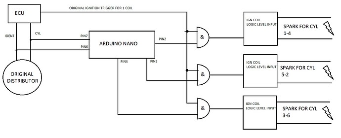

Hello,
I have just picked up an Arduino nano for a project. So i am a complete newbie to arduino, and even programming.
I want to interpret the signal pattern attached in this image.
As you can see the sensor has two signals, the "ident" signal is occuring once in a revolution and the "cyl" signal occurs 6 times in a revolution.
"ident" is the TDC of #1 cylinder.
"cyl" is the TDC of all 6 cylinders.
camshaft signals
The goal of the project would be to use the arduino to drive a wasted spark coil pack instead of the distributor. (which is generating theese signals via hall sensors and vanes)
The distributor would remain connected to the ECU as is, thus the ECU can function as usual, and output an ignition trigger signal. ( timing the spark event and coil dwell)
The engine needs 3 wasted spark coil packs, each firing two cylinders. (1-4, 5-2,, 3-6)
I could drive the coil packs with the original trigger signal from the ECU and a cylinder pairs signal from the arduino.
For example:
each coil pack has a CMOS AND gate driving it. A input of all the gates is the ECU trigger signal.
B input is an output from arduino.
The ECU knows which cylinder needs to be ignited, outputs the ignition trigger signal.
The arduino knows also which cylinder is at TDC, for example its cylinder 5 at the moment. Arduino outputs a digital signal drivng the AND gate for 5-2 cylinders coil.
I have written this code and tested it. It works, sort of.
It needs a synchnorization bit to avoid sending the wrong output if its not certain which cylinder is next. I have tried several ideas that didnt work(commented in the program) , then came up with the last one which did seem to work.
Then i have modified something in the program, now the sync variable never goes to 1, only if i reset the board, then it goes to 1 for 3 pulses.
I hve tried debugging this for hours with no avail.
Please advise. If you have another ideas for implementing this "camshaft decoder", i am open for it.

The car has fixed timing, ie no VVT or anything. Its a Mazda KL V6 engine.
The ignition timing and such is done by the ECU entirely, the stock distributor just allows a "window" of possible spark advance and retard by sweeping the ignition lead post with the rotor for X amount of degrees of rotation, which is the same for the 6 TDC vanes in the sensor.
So this project would be working like a "digital" distributor for wasted spark, the ecu controlling advance and retard, dwell, and timing of the spark event, the arduino output just enabling the original ECU signal to reach the desired coil based on where the cam signals are.
Ok that’s a bit more detail , so presently the distributer is just directing the signal to give the spark and the HT .
So you need something to get the ignition pulse and feed it to a coil pack , replacing the distributer .
You really need to know the system
You have in great detail ( for example Ford Edis based systems can detect faults in the coil pack, if you remove your coil system then you might get issues ?).
Bit advanced this ! It might be worth looking around internet - eg this engine swaps into max-5 , what have they used ?
Personally - why do you want to do this ?
Fortunately i have been working on this engine platform for about 5 years now, doing engine swaps, ECU replacemenets (for OEM units but from another platform) and engine harness rewirings.
I am pretty sure know the ins and outs of this control system. The ECU has no information from the distributor except for the two hall signals.
The distributor has an inbuilt igniter and ignition coil, which are powered directly by the main relay, the ECU just simply drives the igniter with a TTL pulsed signal, giving the spark timing, and the distributor is simply directing the spark to the desired HT lead in the time window, which is given by the width of the rotor face area.
All mx5 and other platforms that never had this engine option are using custom harnesses with standalone EMS. They usually run 36-1 crank wheels, and COPs.
I could go to standalone and be done with this problem, that would enable me to run wasted spark or COP ignition, but i dont want to ditch the factory ECU.

I have drawn a block diagram for what am i trying to accomplish.
