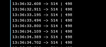

But it doesn't...I think. Here's a screen print of the values coming in from the transmitter while the joystick is at center. (X on left, Y on right)
So I'm checking above and below those values with the IF statements. If it doesn't fit, it goes to default. Do I need a 5th state? Will try the print statement.
Yes, you do. I posted it.
