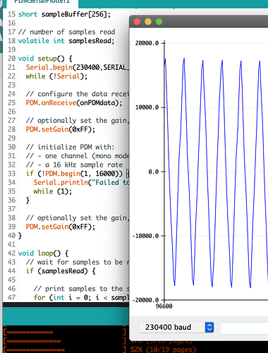

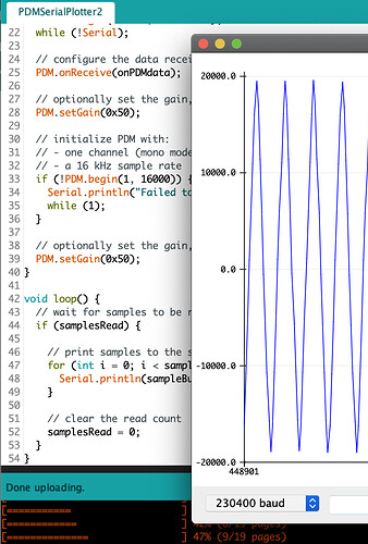

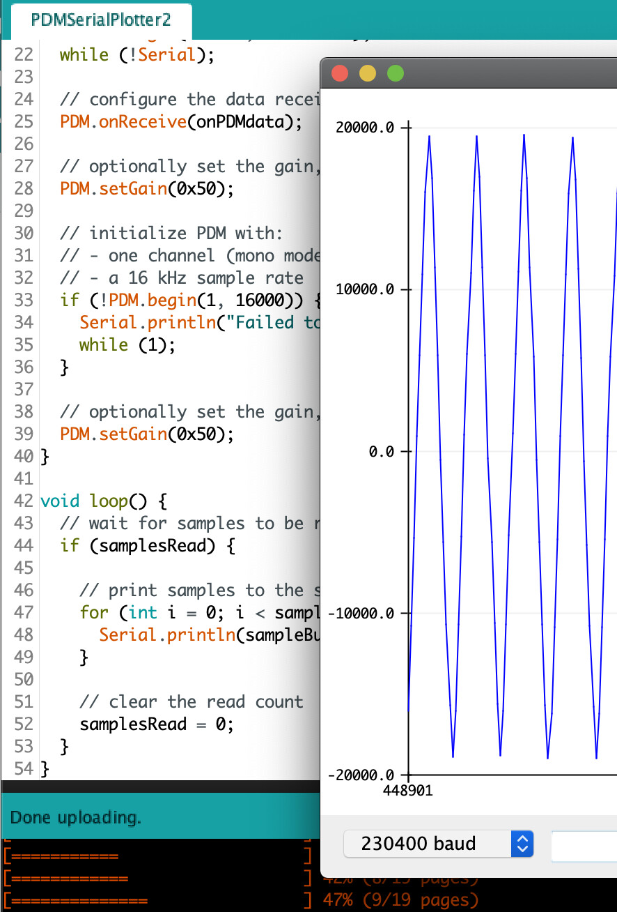

Here are three different waveforms recorded using 1000Hz tone generated by iphone app, sampled by Nano 33 BLE Sense at 16000 sample rate using PDM.h library, at differing gains (0x00, 0x50 and 0xFF)
It shows that setting the gain after begin() is called works, and also that gains 0x50 and 0xFF are not significantly different. Gain 0x00 has a much lower amplitude.
I believe this document should be reviewed and corrected to prevent others wasting time wondering why the PDM samples are not changing, when following the example code.
