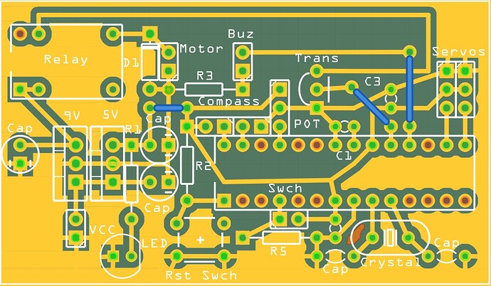

I found a program call fritzing and have designed this:
panobot2.fzz (85.3 KB)
itll be great if someone who has done this before can tell me where ive screwed up. i dont know i have for sure, but it highly improbable taht ild get it right on my first attempt

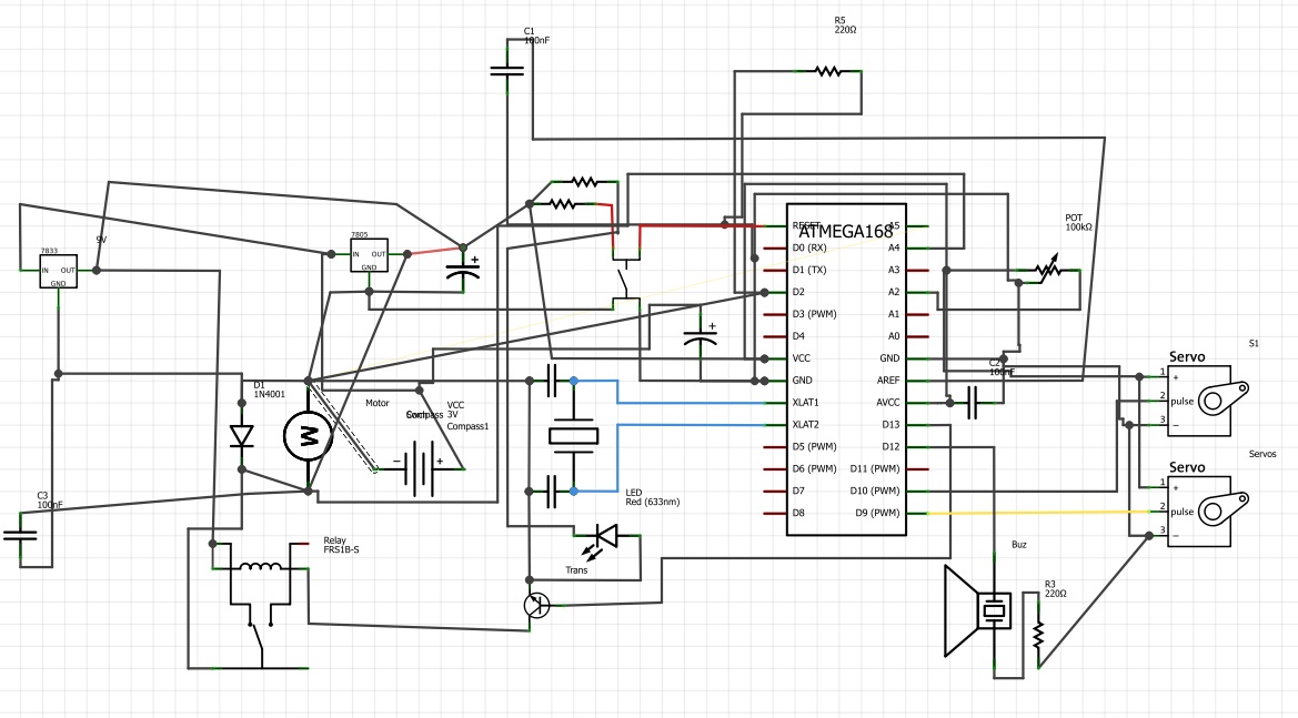

Hard to tell without a schematic to go with it.
its a bit had, the schematic the program generates is a mess. and it going to be wrong, as ive been working on the pcb and just making it fit.here it is with labels. hope that helps. :confused:
No, that's not a schematic.
You also appear to be daisychaining the ground along. Suggest using a Ground plane let everything to be grounded connect to it.
Connecting the lower right signals to Gnd THRU the reset switch and on to half the board is not a good design.
I can see you don't have any 0.1uF decoupling caps on VCC, AVCC, AREF pins so you will also have erratic operation.
I think your LED is also flipped around.
Those kind of things would be readily apparent on a schematic.
You also appear to have Aref connect to Vcc, I believe I have mentioned not to do that, to just use a 0.1uF cap from Aref pin to Gnd.
I Have made the changes you suggested, but still the schematic this program has generated for me is a mess.
you can see that not much is apparent from the schematic but i can see things are wrong with it that are right on the board.
as for the LED, i think your right, but it has the square hole connected to ground and round to power (like all the other parts) its the silkscreen picture thats ares about it recon.
Yeah, that schematic is not workable. Like using a toy for a real design.
