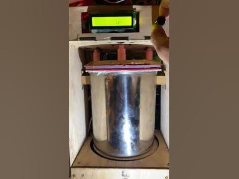

The idea is that I pull a vacuum to draw water out of the plant material, then open the lid to blow it off. Keep doing that until it reaches a certain moisture level. Mold is taken care of with an ozone generator. The moisture content is estimated with two humidity sensors and also a load cell measures the amount of water lost.
Some details: the lid opens and closes with 4 28byj stepper motors. The baine marie is about 3.5 quarts and the whole frame fits it like a glove. I'm using two humidity sensors that cost about 15$ a piece but still their always 10% off from each other. The load cell is 2kg and has a good resolution at the gram level (crosses fingers). I'm using my own pcb's for right now, made on a 3018 cnc.

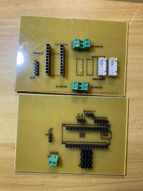

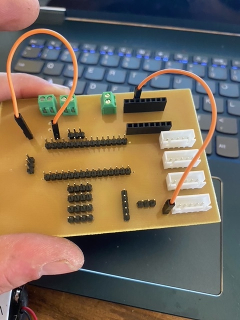

Finally dispelled the hocus pocus, either amazon sent me 4 bad servos or I had put the GND to GND from my power supply to arduino wrong. Funny how I come up with the one possible solution right as I'm about to solve the equation. And I finally came up with a good pcb after two failed attempts. It takes so long to cut these out! But I got all the variables down the chute and cut a good one.
You should solder all the pins to give strength to the entire connector assembly.

I"m not sure if you understand that its a vacuum chamber design, and the humidity inside will reach equilibruim with the plant material depending on its moisture content. I'm 3D printing the lid and putting silicon around the perimeter. I have qwiic cables going into the chamber, through the top of the lid.

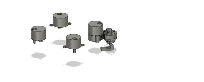

So when i was first developing this prototype I figured I would try to make some gears for the stepper motors to drive the lid

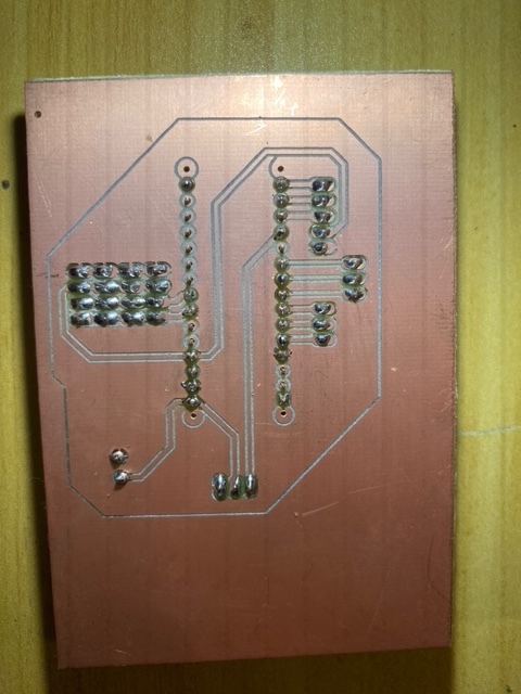

This was one hell of a mistake since it neither worked as well as directly driving them and offset the steppers so much that I had to make two smaller boards to control everything with. So I just went back and redesigned the pcb (post #2) and that went good but I had a huge bomb waiting for me with the rotary encoder. First the stupid thing wouldn't stop scrolling around the menu. After completely giving up until the last thing I could think to do was as chatgpt if he could find the problem. He couldn't find anything but upon taking his advice I realized I hadn't reset the flag variable before the loop restarts! I was so happy, but that was short lived because the encoder didn't really work still. You could scroll with some difficulty, and no button press. Ok so upon closer inspection with the multimeter I found that I had not attached ground to the pcb for the encoder. Boom! well evidently you can use the encoder without power, but when power is there I can only use the button, no scrolling! So I finally have what I think is the correct and final solution: you cannot use pins (13,12,11) for a rotary encoder! I've been so perplexed for the last day!

Well, the lid isn't airtight, it gets back up to STP pretty quick. I'm just drawing a vacuum maybe 5 minutes every hour. The humidity sensors do start going off on there own when the pressure drops but they return back to normal.
I've already tested a little bit and even at just 5 minutes every hour the plant dries really fast. It takes maybe a few minutes when it first goes in. Then once it loses about 30% of its water content it starts to take a few hours for the humidity to level off.

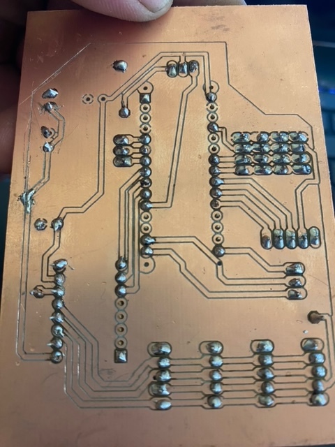

I accidently put twelve volts on the 5v line and lost a humidity sensor, so I decided to double down on my pcb making. I figured out that I was way off on my numbers, I was using .05mm depth at 35mm/min feed rate, when the best results where at .2mm depth and 60mm/min. Quite the difference when i don't have to scrap the traces! I also decided to use my laser cutter to put on some signage. Its actually really easy to do, and I did these from design to finished in just one day.
Looks a little rough, but on the next design I will know exactly what I am doing!
