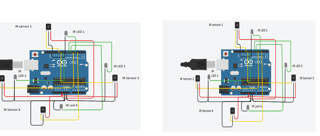

Device ID and direction detection in swarm intelligence using IR communication?
I am using a arduino uno connected with 4 HS0038 IR sensor on 4 corners of arduino .each ir sensor is accompanied with a ir led which will be transmitting a specified code in 4 directions the code will be unique for each module (refer figure).the arduino module can receive the codes from nearby module with the help of the ir sensor and will tell its own presence to the nearby module with the help of ir led. but all 4 sensors on the module are picking up the code even they are far apart. I can't understand what i have written wrong in the code and why the sensors are picking up the data even when i try to isolate that particular sensor.

Do you have shielding tubes over each IR LED and IR receiver?
