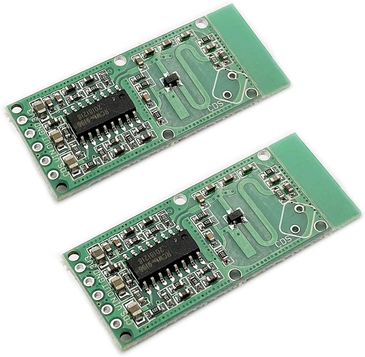

Google RCWL-0516.
These modules need clean filtered power for best results.
