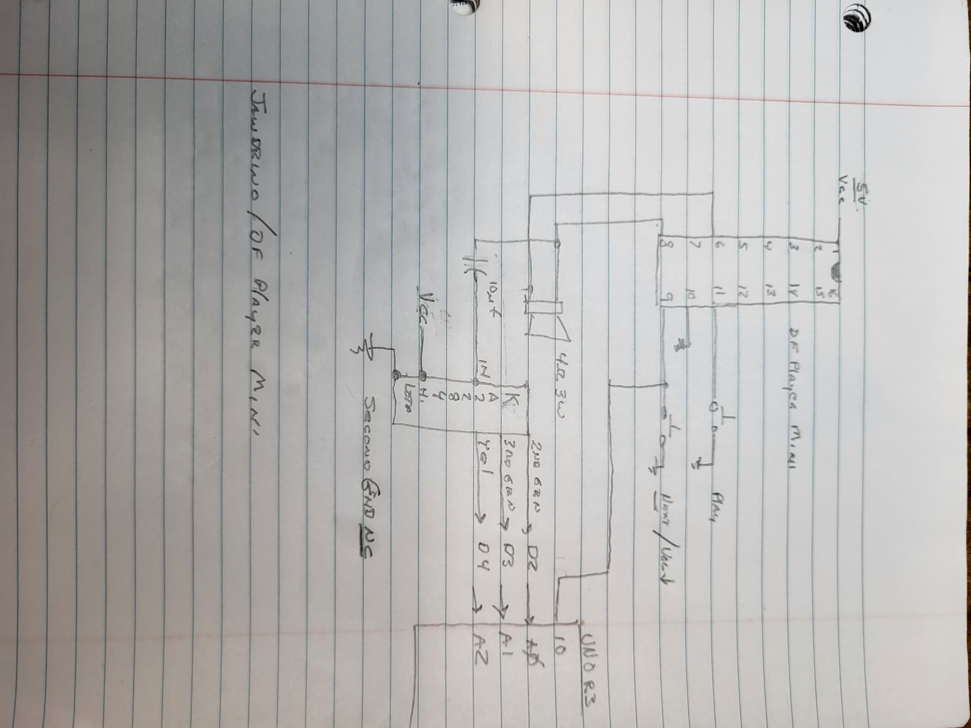

I'm working on a Halloween skull prop for out haunted barn we are use each year for dollars for scholars. At the moment I have a basic working setup using "jawdrino" shared by buttonbanger,com. The jaw moves every smooth however a laptop was used to demo this capability. Thank you! if you listening, It works great using my PC.
Im trying to adapt this setup to include use of a DF Player Mini which would play ~10 different scary talk tracks automatically selecting the next .mp3 file or a random one. Unfortunately I only believe I know the following about whats needed in the sketch:
1.Most likely I will need range of .mp3 selections (say 10)using a stepping or random number generator and the ability to take this number apply it so the next song is selected and played.
  1. Additionally I expect that there should be a monitor to ensure the selection playing has completed before starting the next.
Yes I'm still a newbe and I have seen some parts of this online but not yet able to put anything worth sharing here. Apologies if this has already been done and I missed it.
Im working with an UNOv3 and DF Player Mini. So far I have managed to get the DF Player Mini to work with the basic jawdrino sketch but have to push a button to play the next selection.
I can probably figure this out but need some help with the framework to get it started correctly.
Below is the link to see the jawdrino setup:
Thanks in advance
Can you show the current sketch that includes the player.
What will trigger the playing of the next song if it's not the button. A random delay? Or will they play straight after each other?

I did watch this well done video and in the end all I really need right now is a way to enable "play next" (pin9 on the player) from the Adrino without depressing a switch.
Today I looked over the details for the DF Mini (DFPlayer Mini Mp3 Player - DFRobot Wiki) and discovered there is an example file at the end that may get this working. Ill play around with this a bit more and update this later. Attached is a copy of the basic hardware setup currently in test
Sorry it came over sideways
Fixed! : )
Hello @dnfriedl67 - Some suggest using DFPlayerMiniFast for solving a "play the next track" problem using isPlaying() to wait for the present track to finish before starting the next. The link shows the API functions available.

This project is now basically working as intended. At the moment all 10 of my test .mp3 files play correctly and the servo responds as expected. Apologies i read over the 'is playing" information and not sure what instructions I need to include. The newbe in me is not picking this up.
Below is a copy of the Sketch I created using different sources hopefully giving credit to those that originally created the initial structures and adding my comments.

Here is a pix and hardware layout
I need a new camera... looks good on the PC
