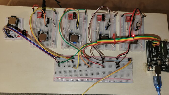

Hello,
Recently I created a board with multiple DF players to output separate audio sources to designated speakers. Unfortunately, I'm running into a problem with playback on these boards. I have wired the boards as shown in the pictures. I am making use of the IO pin, which is supposed to trigger either the previous audio file or the next audio file. However, the DF player seems to be completely ignoring this, and instead plays the smallest or largest audio file first, and ignores the order of the files on the SD card. I have them labeled as follows: 00x.mp3, and have tried changing the format several times to include numbered folders, more leading zeros, and anything else I could find on existing tutorials for the DF player. Changing the format made no difference.
Has anyone else run into this problem? I am unable to make my DF player play the audio files in order of their file names, even though I am using the IO pin, and not the ADKEY pin.
Here is where my issue gets even weirder, though. I originally had the negative side of my 5v power supply connected to the ground on my Arduino board, and the largest audio file would play first. When I removed the connection to ground from my board, the trigger would still activate, but it would instead play the smallest audio file first. Apart from this odd flip-flop, I was very surprised that the digital OUT from my Arduino board was still able to activate the transistor, given that there was no completion of the circuit via ground to the Arduino board. This entire situation has completely confused me, and I'm hoping someone with more experience can identify the problem, as well as provide some insight on how my digital OUT pins are still able to saturate the transistor despite the absence of a pathway to ground on the Arduino.

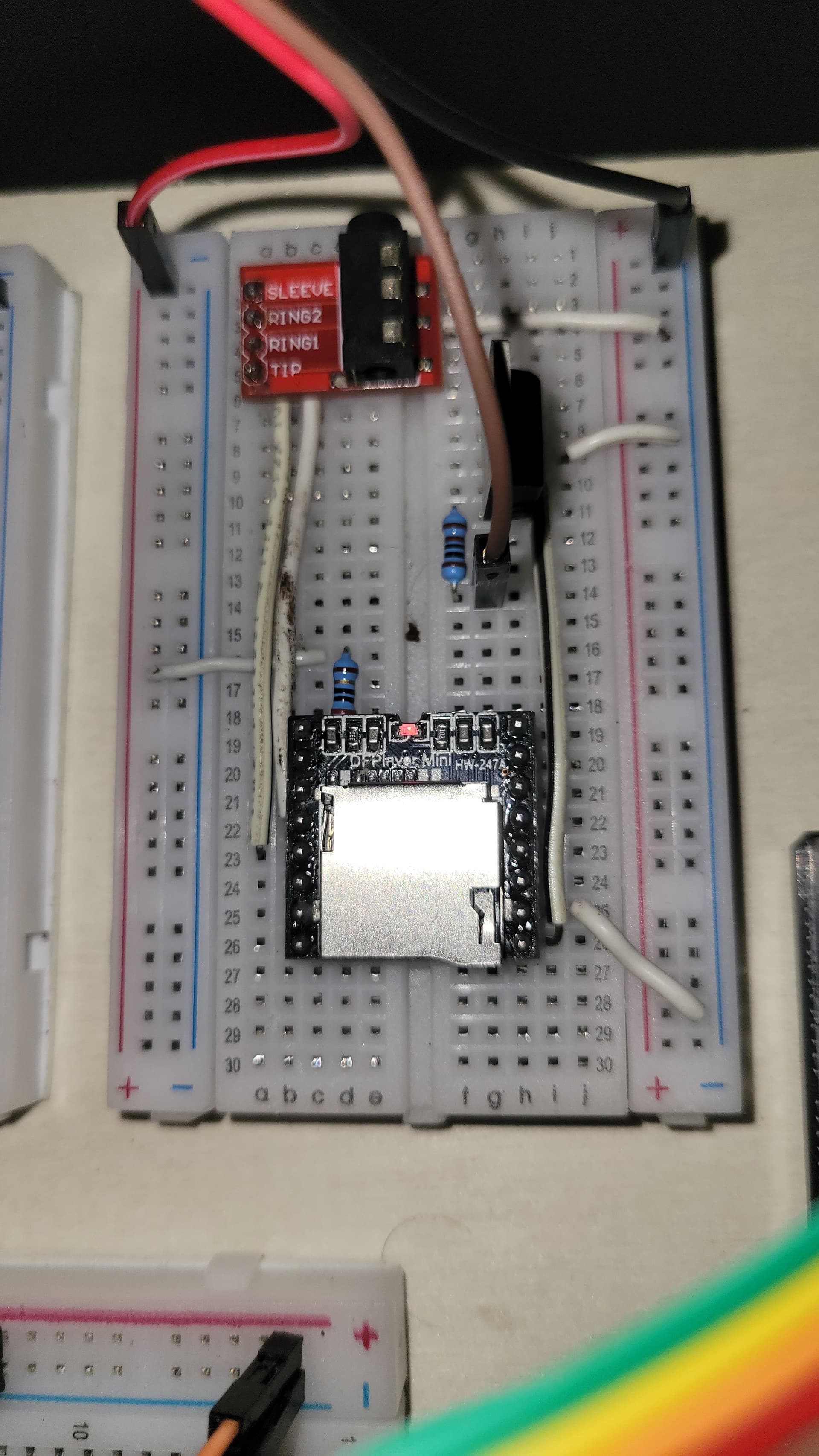

To further help with the troubleshooting process, here is a description of the DF player breadboards:
-Positive 5v on the far left side, with negative 5v on the far right
-Transistor wired to close connection to negative 5v when saturated. Base connected to Arduino digital OUT with 10kohm resistor, collector connected to IO2, emitter connected to 5v negative.
-DF player mini connected directly to 5v negative
-DF player mini connected to 5v positive with 20ohm resistor
-3.5mm audio jack wired to DAC_R & L pins, also connected to 5v negative
-All DF player breadboards are connected to the large breadboard at the bottom for power distribution. The 5v power supply cables are the orange and yellow jumper cables connected on the far right.
If you have read up to this point, I really appreciate your help, thanks!

Maybe the ground is common further up the power chain?
What do you mean by that? Right now there is nothing connected to the ground pin on my arduino, as you can see in the picture, yet it still works. Everything is tied into the 5v power supply, however I have always been under the impression that for a digital out to work, it must be a full circuit back to ground on the arduino.
Your Arduino ground pin is connected to the 0V of the USB connector which is connected to the 0V of your PC.
Where do the 5V supply orange and yellow cables go to from your breadboard?

Thanks Mark, I'll have to try that out. I was working with them yesterday and found something interesting. In order for the files to play correctly consistently, I have to re-format the sd card every time I make a change to the files. I'm not sure why this is the case, however so far it has worked without any issue. I'll test out DriveSort and see if it doesn't require me to reformat every time.
As for the grounding issue, there is no jumper cable connected to the ground pin on my arduino at all. The only cables connected are to the digital pins. The 5v power supply (orange and yellow cables connected to breadboard) go directly to a 5v plug in wall adapter. I'm still confused as to how my digital pins are working, as they have no path to the arduino ground.

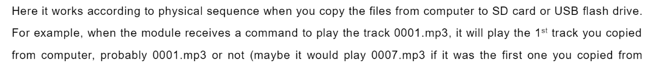

If you take a look here : DFRobotDFPlayerMini/FN-M16P+Embedded+MP3+Audio+Module+Datasheet.pdf at master · DFRobot/DFRobotDFPlayerMini · GitHub you'll see some info on page 3. Basically it says its done by date not by filename - it needs a numeric strucutre to the file name, but ignores the numeric sequence and goes by write date.
The page 3 I read makes no reference to "date" and the word "date" does not appear anywhere on that page as far as I could see.
Thanks edster, I do see that. That's weird, because all of the other datasheets that I looked at had no mention of anything like that. I'll keep that in mind from now on.
If you read the very first line .....
Yes, and there's no mention of a date or time. What they are probably referring to is the order in which the FAT is populated with the files. The player probably plays the files by traversing the FAT entries sequentially from the first to the last. The embedded play probably doesn't have the spare RAM to be able to load up the complete file list and then sort them.
It doesn't use the words date time, but I don't know how else you would interpret '.. the 1st track you copied from computer..'
Perhaps:
Well that is different. The document refers to it in terms of the sequence in which you bring things from the source, your option refers to a changed sequence on save at the target. It's possible, I guess, but that's not what the document says.
