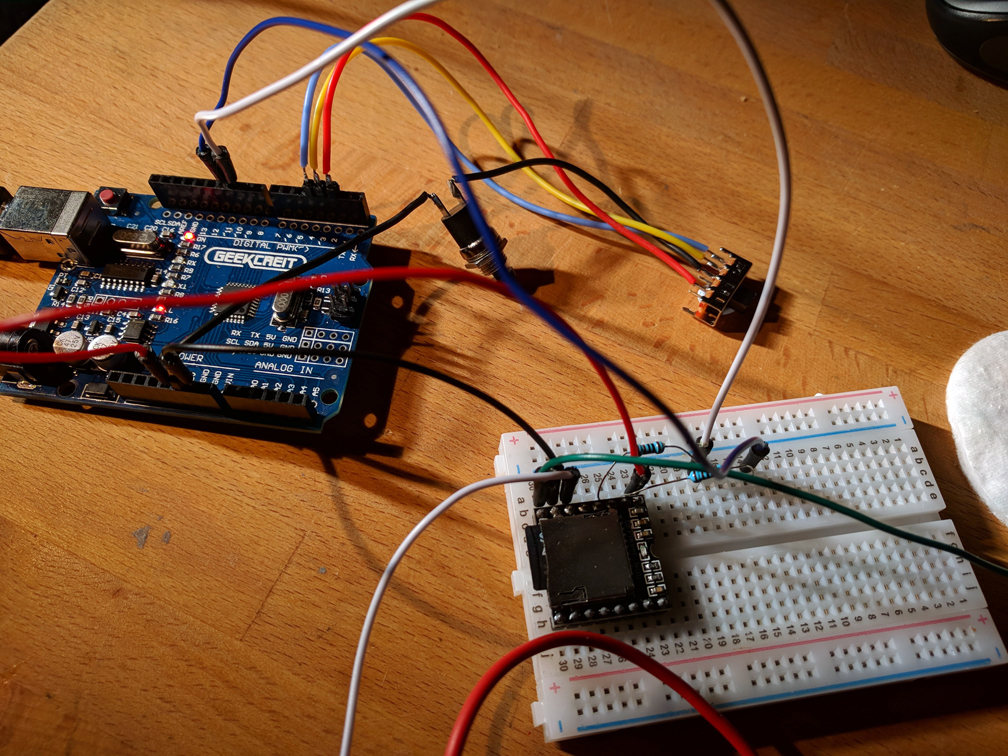

Can't think what I'm missing here - this DFPlayer (attached to an Arduino) won't stop playing mp3s on first power-up. It functions normally after that.
Anyone else found this "feature"?

Wondering if you have a pin grounded or something? triggering the button only mode type of playback?
If the playback is triggered by this:
Serial.println(F(“Initializing DFPlayer … (May take 3~5 seconds)”));
Then… no that does NOT seem correct to me.
(thats a serial print line for the serial monitor… not even directed at the DFPlayer)
Both boards should be powered at the same time…and the Arduino should set up all default params for it.

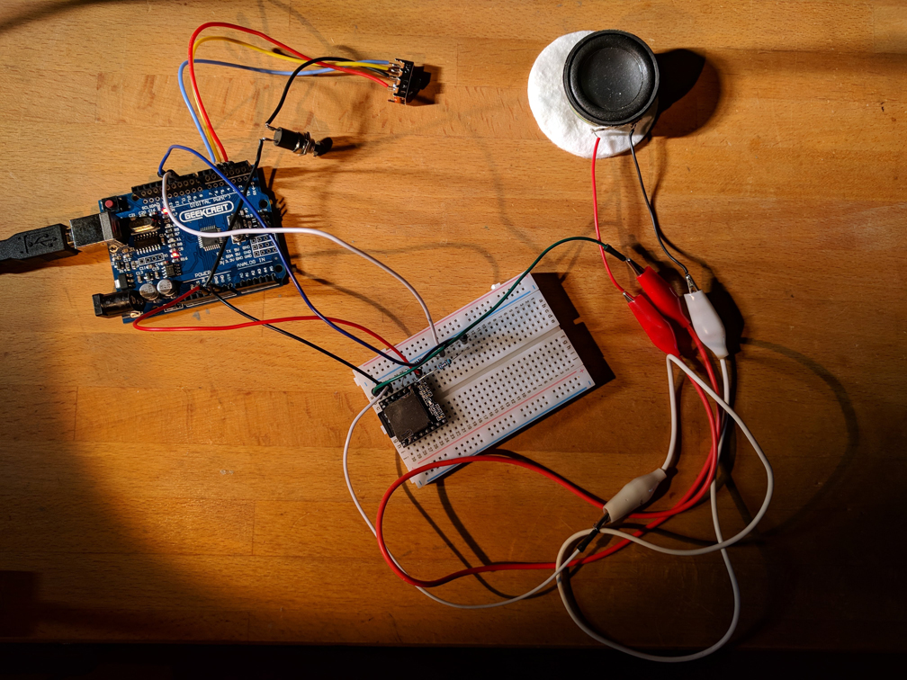

Can you post a pick of your set-up and wiring?
I just quoted that line because it mentions “May take 3~5 seconds” which seems to be the time it takes before the Arduino tells the DFPlayer to shut up.
It’s all badly wired together at the moment so these pictures may not help very much but attached anyway.
I’ve also ordered another DFPlayer this morning in case this one is just plain faulty.
No pics attached. :slight_smile:

Currently.. my best guess is that one of the I/O pins of being triggered
They should be attached now - the forum first refused the pics because they were too big so I resized them by which time the forum had decided I'd posted too many times in the past five minutes.
It's a blue LED.
Wow. So your last comment - “that one of the I/O pins of being triggered” - just made me take a much closer look at the board where I saw that a there was a trace of stray solder shorting the bottom-right two pins - GND and IO_1. A manufacturing defect I think, since I’ve not been anywhere near this board with a soldering iron yet. You might just be able to make it out in the attached.
I scraped it away with a scalpel and now it’s functioning correctly.
Some sort of lesson learned! Thank you for your patience and your code and sorry for wasting your time.
