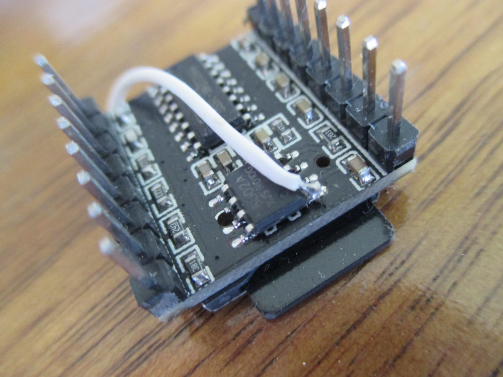

It involves isolating/disconnecting/lifting up pin1 of the 8002 audio amplifier chip, and connecting it with a piece of wire to the busy pin of the DFPlayer. You need smd soldering skills for this.
After that the amplifier part of the module is put to sleep when no music is playing.
Leo..

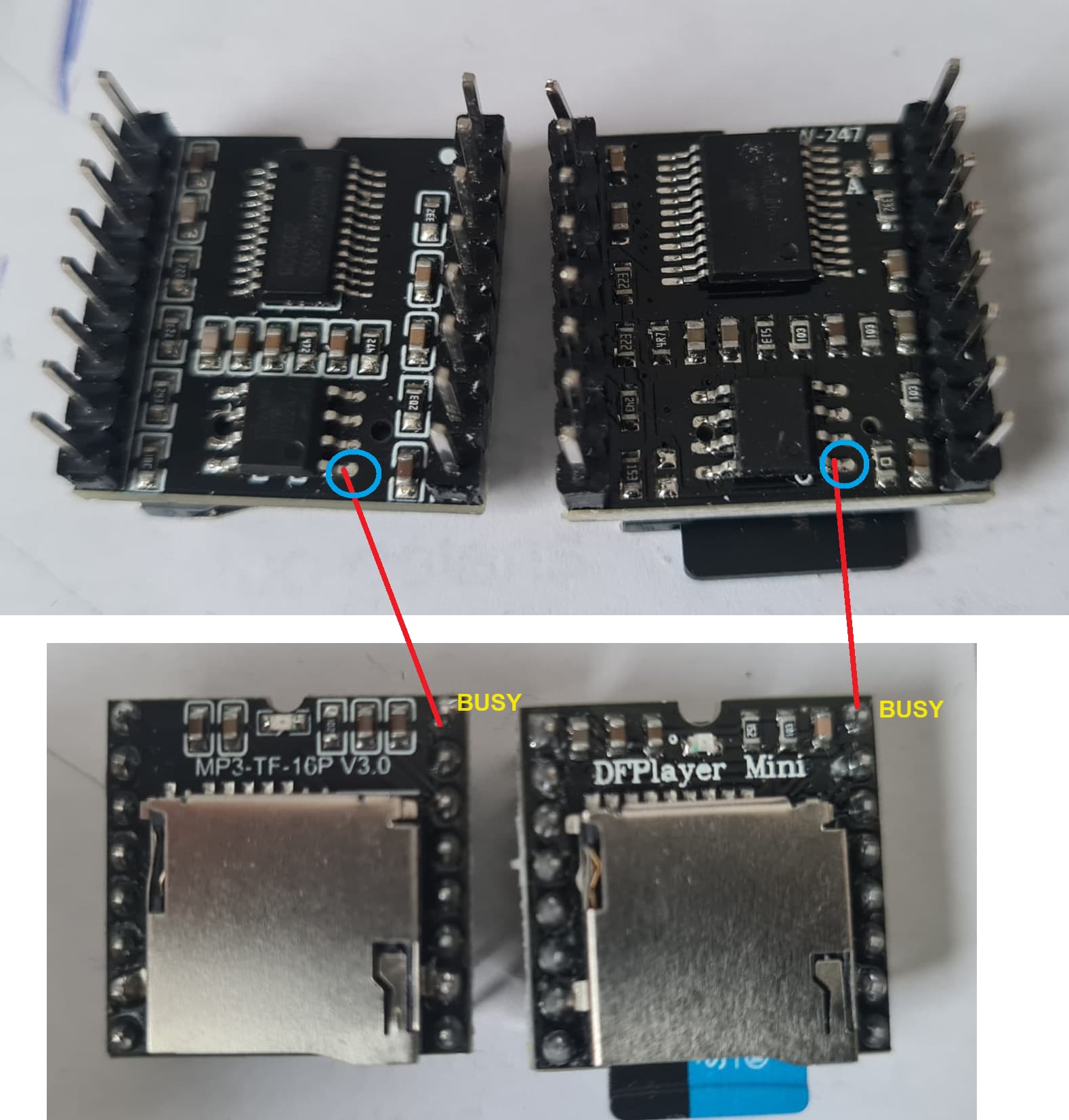

Maybe post an image of df player and put a line where need to connect
Here you go.
I had to lift pin1 off the board, because my module didn't have the 0ohm resistor that the board in the article has. The wire is soldered to the lifted/disconnected pin, and goes to the busy pin (was easier to solder the wire on the other side).
Leo..
so first disconnect pin (blue circle) from PCB and then connect it to bussy pin
@arpa123
You've posted a pic showing two different players. "DFPlayer" is used in a generic sense, for real DFPlayers and clones alike, but the builds are not the same.
