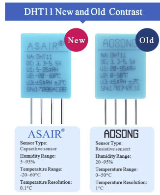

there is a (five year old :wink: ) page on DHT11 and DHT22 created by seeedstudio
DHT11 vs DHT22
where they talk about two versions of DHT11 modules
If you have both it would explain the difference (apart from other issues).
