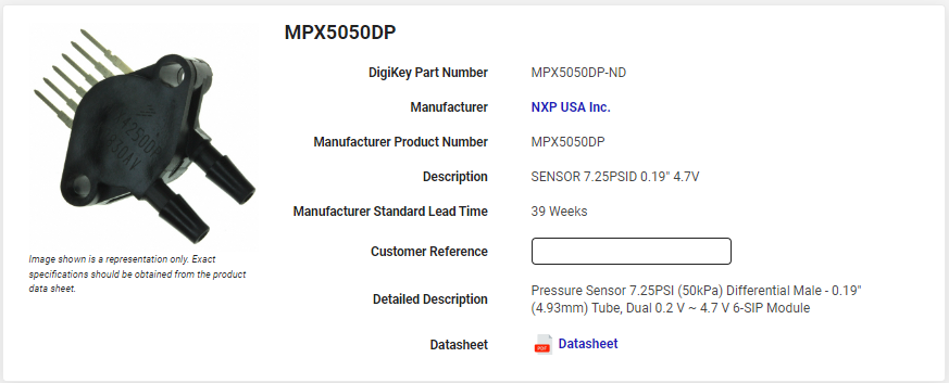

I haven't given up. I've just been rethinking my whole setup, like you said. I've been looking at the MPX5050DP.
It looks like I ought to be able to connect this to the 5V, GND, and A0 on the Arduino Uno R3?
I don't know why I thought I needed to have that expensive external differential pressure sensor and complicate it with resistors and whatnot. This MPX5050DP seems to be a much cleaner, more simple solution.
The specs say it draws 4.75V ~ 5.25V, so hopefully the 5V on the Arduino can handle that.
The specs also say it outputs a 0.2V ~ 4.7V signal, and please forgive my ignorance, but I assume that I can apply whatever unit of measure to that I want? I could have "inches of water column", or "mm of water column", or PSI, right? I'd just have to somehow calibrate the sensor so 0.2V is 0 and 4.7V is whatever the maximum value turns out to be.

The MXP5050DP says its max pressure is 29.01PSI (200kPa), and I don't think the filter houses would ever have a differential pressure that high, so it might be a bit overkill that way.
Am I on the right track with this?
I see from that picture of the analog guage in post #29, it has a max value of 80mm of water. That's only 0.785kPa, so 200kPa is probably way to much
That is the max allowable D/P. The working D/P is 0 - 50kPa which is 0 - 5098 mmwc. 80 mmwc is only ~ 1.5% of that range. That is only 16 different values on a 10 bit A/D converter, unless you use some external electronic scaling with an op-amp circuit.

Yeah, this might be a problem... 0-80 mm of water is 0.01 PSI to 0.12 PSI, so these are pretty small pressure changes we're talking about.
How can I tell if the MXP5050DP can even measure pressure changes that small?
Its easy, it cannot.
I say this because I've spent some years evaluating pressure transducers for automotive applications. The issue is the zero drift, aka the output value when no pressure is applied. The zero drift on the MXP5050DP has a range the covers most of your measurement range.
The max range is 50kPa or 5100 mm water.
Divide that by the ADC size, for the uno, it 10 bits so it 2^10 = 1024
5100/1024 = 5mm water
That would be the minimum and also the resolution which is actually less than the analog meter resolution. That is if everything else is perfect.
So you want to find one with a range of about 1kPa
