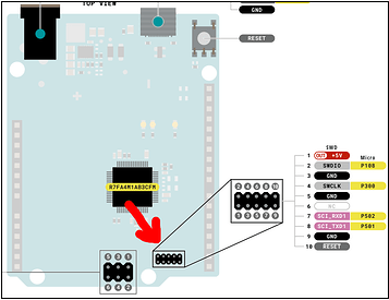

Hi @roujesky. Do you have a debug probe connected between your computer and the SWD header on the UNO R4 Minima board?:
UNO R4 Minima Full Pinout, page 2 by Arduino SA - CC BY-SA 4.0 (cropped, annotated)
A debug probe is required in order to use Arduino IDE's debugger with the UNO R4 Minima board, so if you don't have one connected then it is expected that the debugger will fail to initialize.

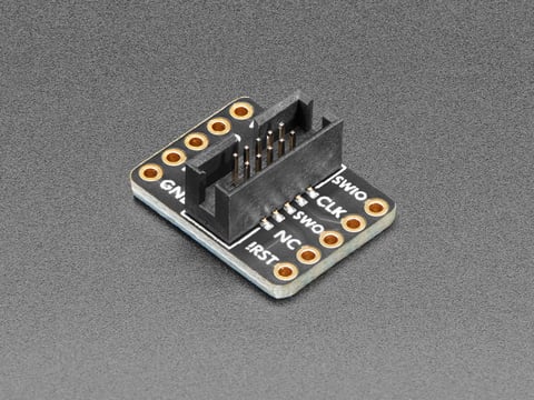

Unfortunately the Raspberry Pi Debug Probe doesn't have a standard SWD header like you see on the UNO R4 Minima, which makes it a bit inconvenient to make the electrical connections between the two. I recommend getting one of these nice breakouts:

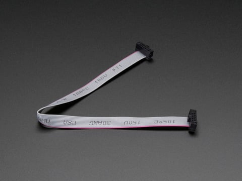

and a cable to make the connection between the header on the breakout and the header on the UNO R4 Minima:
The Raspberry Pi Debug Probe comes with cables that adapt from the JST connector on the probe to female or male "dupont" connectors that you can connect to headers you solder to the SWD header breakout.

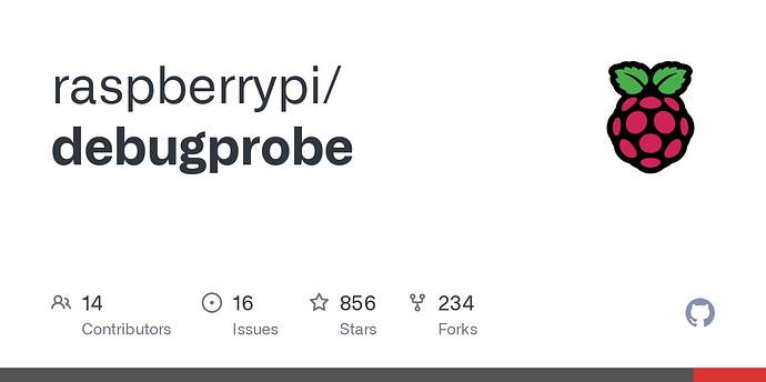

This is done by installing a special firmware on the board. You can use the same firmware that is used by the Raspberry Pi Debug Probe, which I have used successfully:

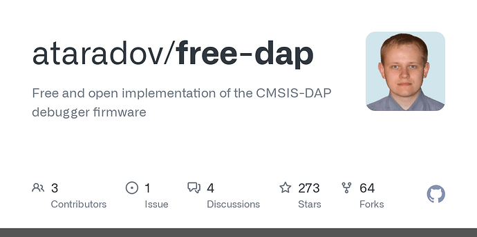

or this alternative firmware, which I have not personally tested (but I have used it with different hardware and it worked perfectly):
