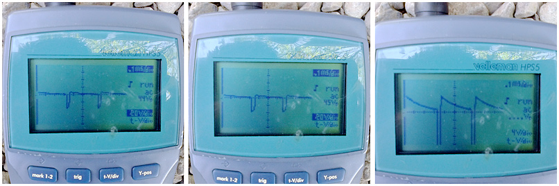

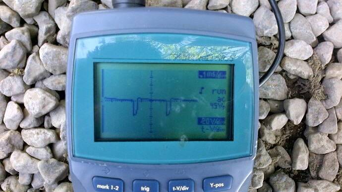

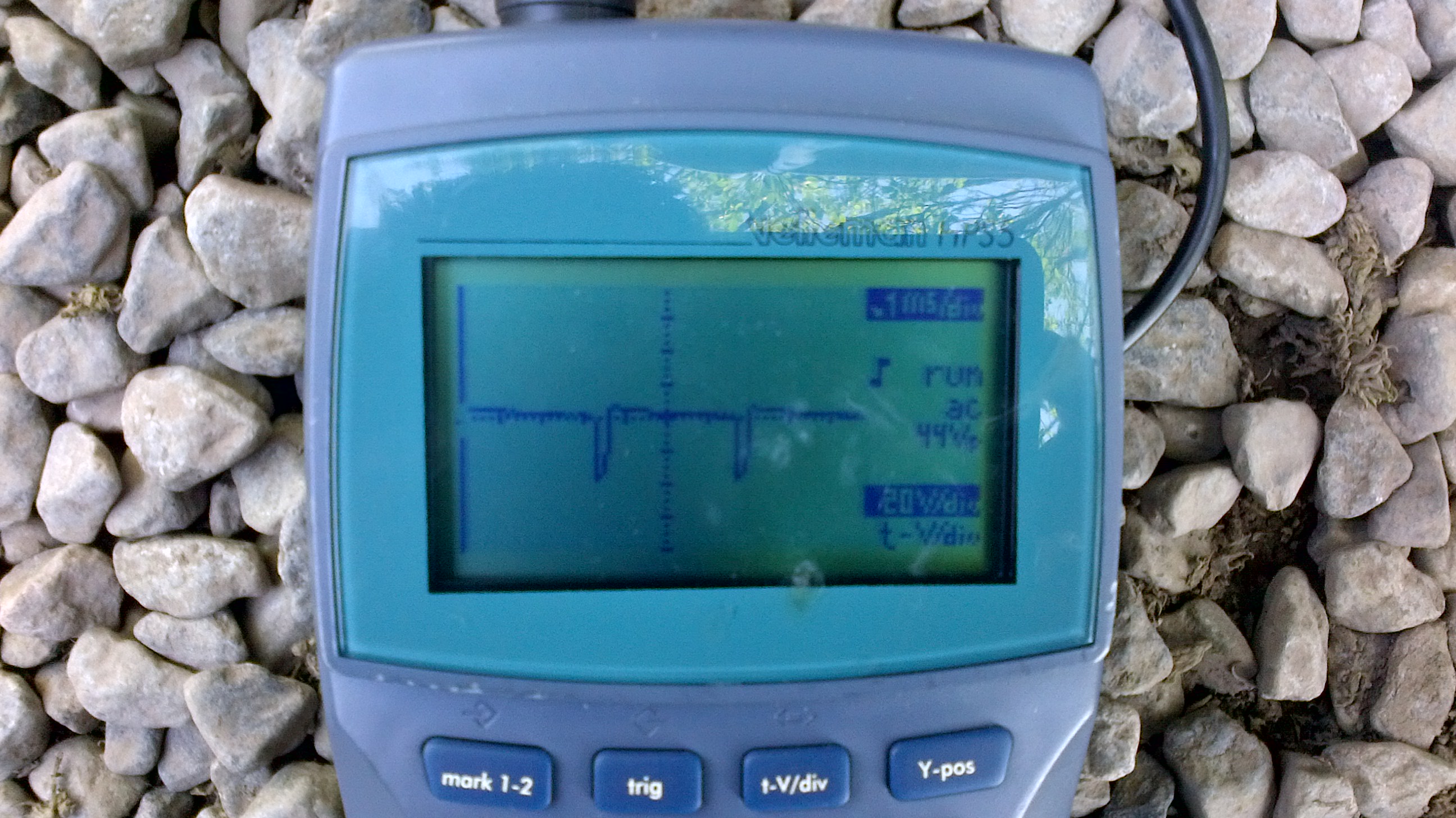

Problem is, I built a potential divider, tested it on the 150V 'PWM' and got some strange results.
My PD is made up of a 10k and a 330R (high wattage in consideration of the 30x volt drop). I expected to see a peak voltage of around 4.5V after the PD, but instead the peak was reaching nearly 50V and the pulse shape was not square. It looked more like the signature of an inductor - See attached pics
I double and triple checked my PD and it's correct. Is there something I'm missing here? What do you think could be causing the high voltage to be passing straight through my PD? And why the odd shaped wave rather than a pure square wave? Could it be that the device actually doesn't output true PWM or is it more likely to be something I've missed?

The PWM of that controller is usually called phase control. It is basically an industrial light dimmer. A triac is turned on after the zero crossing, wait later and the light is dimmer.
http://www.pic_examples.byethost3.com/Dimmer.html
It requires a load to work. Without sufficient load, the triac won't stay turned on and you'll just see a short pulse.
A peak reading DMM used without a load on the dimmer will likely read 150V over most of the adjustment range, or it may read values that don't seem to correlate with the setting.
Put a 100W incandescent bulb on it and try again.
Because of that waveform, though, you can't just read the peak voltage to see what the percent power is set at. You'll want to look at the time when it triggers after the zero crossing.
BTW, I can see the quarks your scope is made of. Crop and resample?

Also, sorry about the mega size jpegs - they were straight from the camera on my tablet. I've attached a cropped and resized version of the original scope readings.

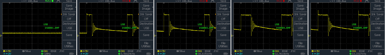

I have since managed to get a digital scope onto the output and attach the results. These readings are taken with a 15K load resistor. Kinda looks more like PWM maybe, but that said, there's something unusual with it. Note the frequency increase. Images 1 through to 5 are steadily increasing the control from 0-100%.
Does this throw any more light on the matter or make things more confusing perhaps???

Hi, I think you will find that the five traces show that you have fixed frequency and adjustable duty cycle.
The trace display is 6.8 x 50uS= 340uS, approx 2941Hz, in all of the screens, the digital display is being fooled by the ringing on the trace.
What are the inputs and outputs to the dimmer, and what has it got written on it.
How also a diagram as to how you are measuring the traces, is the input from a potentiometer or from another control circuit.
Please some sort of diagram/picture of the device and how you are connecting it.
I'm not sure where the 150V is because the trce shows 15V pulses unless you are using a 10x probe???????????
Tom...... :slight_smile:
I second what TomGeorge said, now that I can see the images.
So this is -not- running from line voltage, but is straight PWM from a DC voltage.
What I said about a load still applies. You can't simply apply a DMM to a PWM and get a meaningful reading, unless perhaps you have a true RMS reading meter and the PWM signal is within the meter's frequency range.
