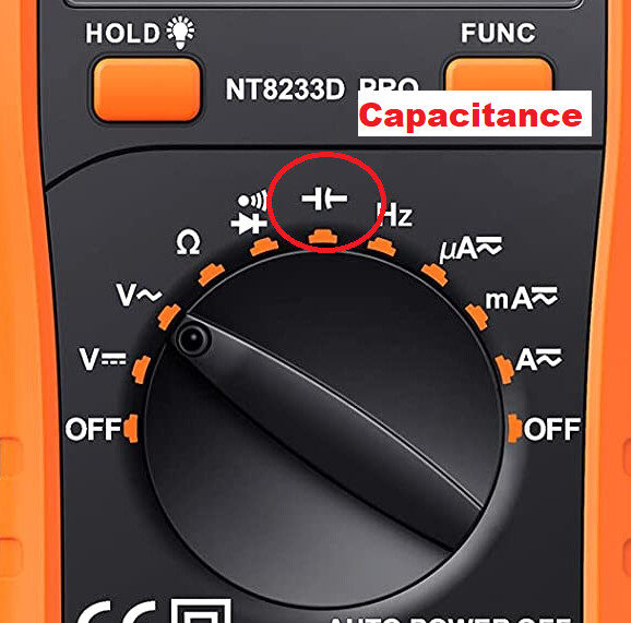

I would like to get a new one as the above is not so stable when using the continuity mode and also seems not to measure capacitance.

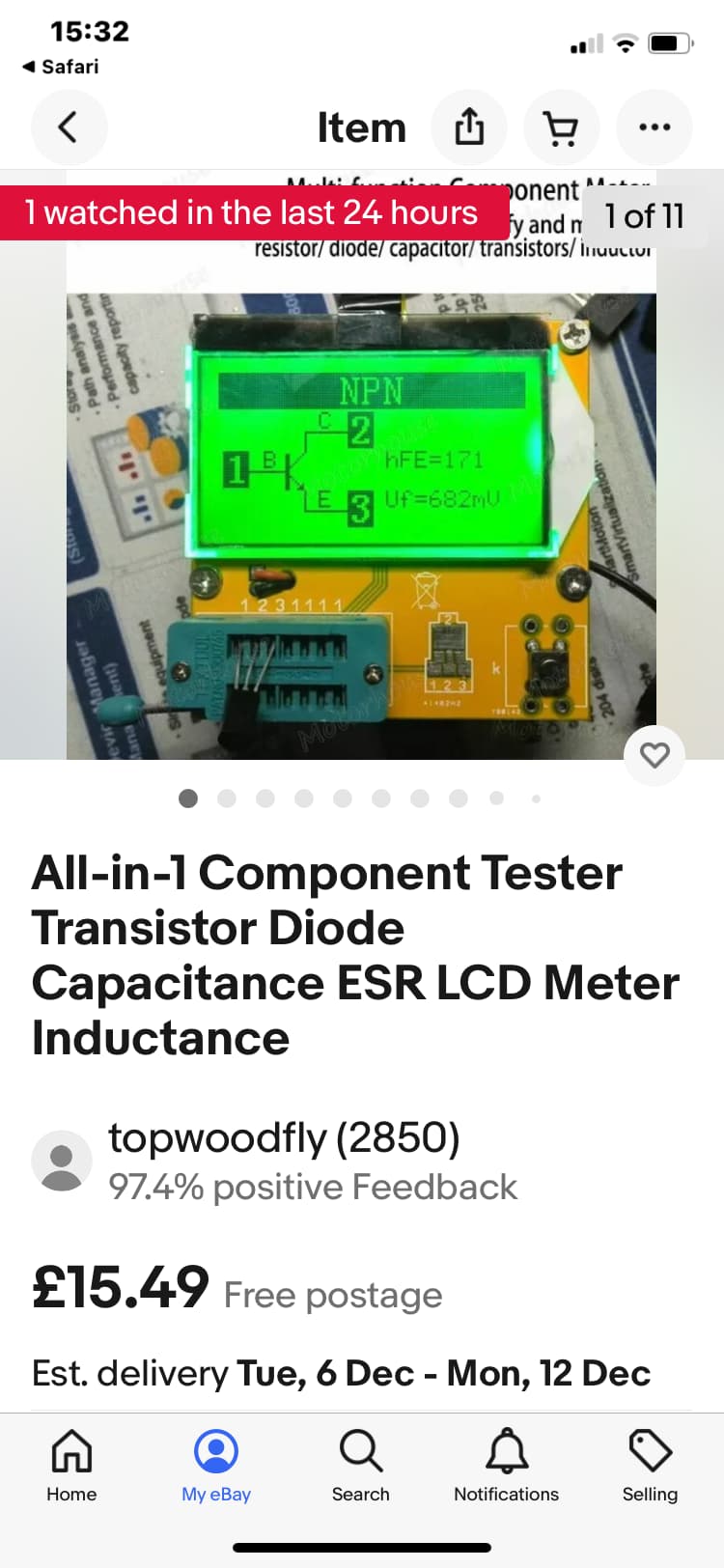

I have one of these for component testing - does caps, resistors , transistors, inductors. Etc . I think the code is around to make one with your Arduino (?)

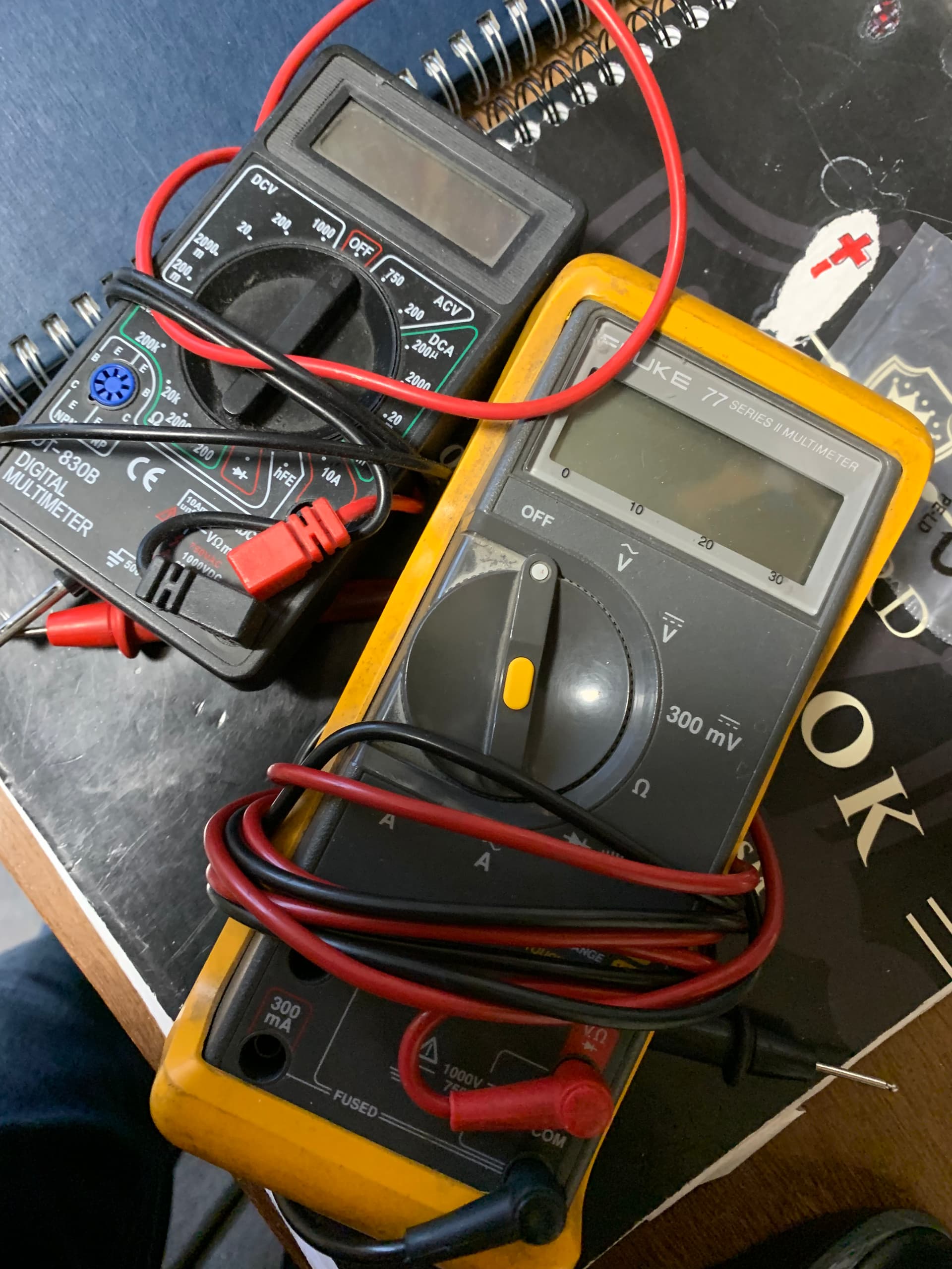

I have a fluke 77 I’ve had for 15 years , and a recent check showed it still to be in spec .
I also recently bought a cheap eBay one , which lasted a few months .( spot the cheap one )

Lets say I have a 100nF capacitor - I never manage to read this value using my DMM. Not sure why..

The description says it 4-2000uF so it can't read nF or pF (if that's true).

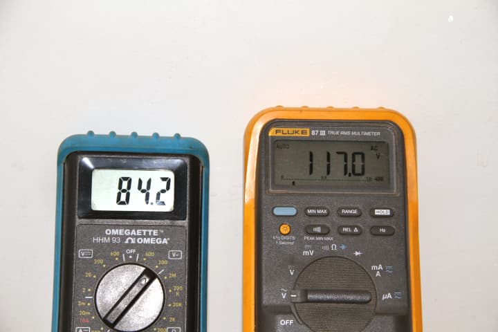

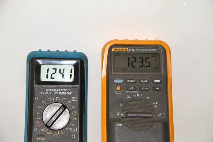

Something I failed to mention earlier is while today most decent quality DMMs measure true RMS voltage there are still those Average Responding RMS Indicating. Here is an example of what I am getting at.
Both meters are measuring a 120 VAC 60 Hz wall outlet, measuring a sine wave. Close enough. Next the same two meters are measuring a MSW (Modified Sine Wave) from a UPS inverter.
Both meters same point of measurment. Early DMMs with true RMS responding were expensive but today they have come down in price. Very few of the early Analog meters were RMS responding. Anyway just something else to consider. :slight_smile:

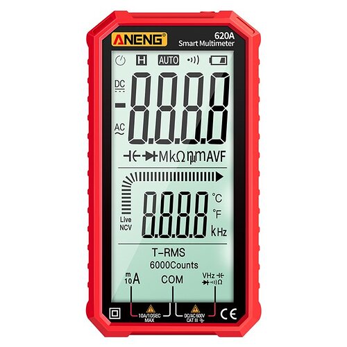

I wanted a full featured dmm with big display and audible continuity test. This one does that and more. Non contact voltage sense and measues caps. It even lights up LED's!
Bought thru Walmart for ~$35. Came with temp probe and test leads. Batteries separate.
That look interesting. I found it on amazon as well.
How do you find the touch screen? the quality of the prob that included?
Not touch screen. Power button on top, select on side, but it'll identify & measure automatically. Leads are normal test leads, supple silicon, red & black.
