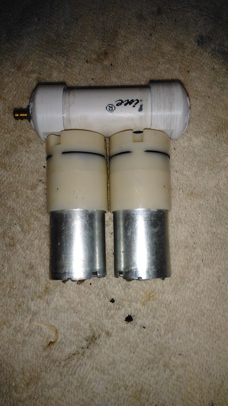

The air pumps I am using for the application require two for the pressure I need and what I have done is put the two together and made a small air tank for them. this makes it pretty stable but still want it a little better.

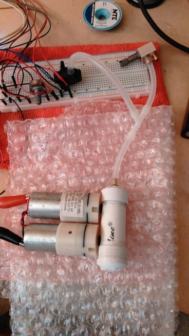

Can you post a picture of your project and/or a diagram of your air flow through the pump and out to the pressure sensor and vessel.
If you are trying to get the pressure of flowing air, then you have to consider the physical arrangement of pressure sensor and "pipe".

Ok i have added a pic of the setup! My issue is the pumps being the kind they are, but I don't know if I can get a small different kind that can provide constant flow of air.
I can put air into the sensor with a small syringe and then clamp it to hold the pressure and it is stable, so I now know it is not the setup, noise etc.
Do you have room for a separate larger storage cylinder to have the pressure sensor measure.
Because you are measuring from the pipe, you are measuring pressure like a pitot tube.
This is effectively measure flow and pressure.
Pump impulses will be a problem, a separate storage cylinder will help.
You may try measuring at your tank on the pumps, but not from the outlet pipe.
