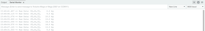

then receives raw data from the digital scale displayed on the serial monitor like this
I'm still trying to do data parsing so that I can retrieve only the weight of the scales.
All data is in a fixed position, so parsing would be easy. No need to search for the commas, but you could do a check to verify they are all in the correct location as a method of detecting errors.
yes I know this I'm trying to make data parsing but always error hahaha

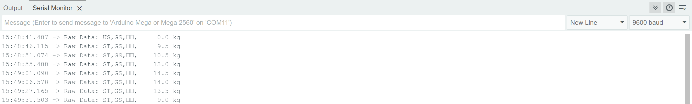

and this is the output
The results that are issued are what I want, but is my coding efficient? I tried to make a coding to take the weight number of the scale and it always errors and I tried to make a coding like the one above.
The use of Sting (capital S) is never efficient :wink:
You will have to look at the data as posted in post #24. You seem to have non-printable characters in the 3rd field (device ID and lamp status byte); it will be difficult to parse that and there is the risk that their value is a '\n' and it will break the reading.
yes, I have trouble parsing because there is data that cannot be printed on the serial monitor and sometimes makes my parsing error. then if not using String (capital S), what else to use?
Your first improvent will be to change if (receivedData.length() > 0) to if (receivedData.length() == 22). The 22 assumes that readStringUntil() under normal circumstances gives you 22 bytes; you might have to adjust that a little if the '\n' is stripped off by readStringUntil().
