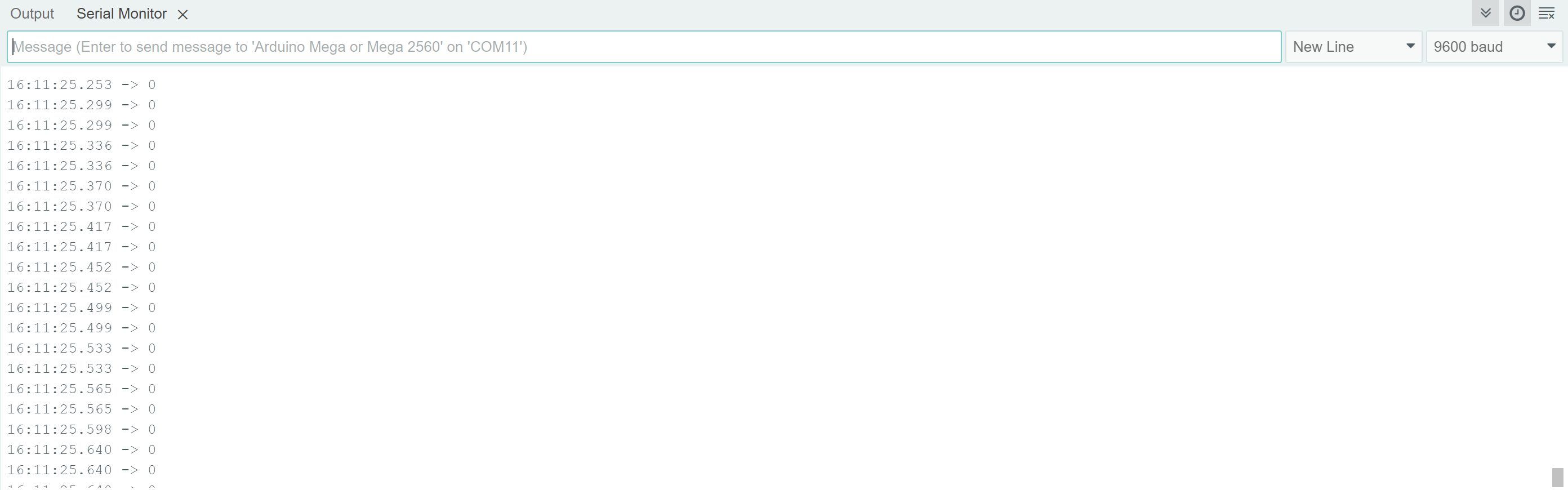

Hi I want to ask, I am trying to receive data from a CAS CI-200SC digital scale Manual Owner with Arduino Mega using RS232 to ttl MAX3232 with serial hardware. This is the code I used for testing.
  Serial1.begin(9600);
  if (Serial1.available() > 0) {
    Serial.println(Serial1.read(), HEX);
but from the coding above, the 9600 baudrate serial monitor only displays 0.
please help me so that the reading value of the digital scale can appear correctly in my arduino serial monitor.

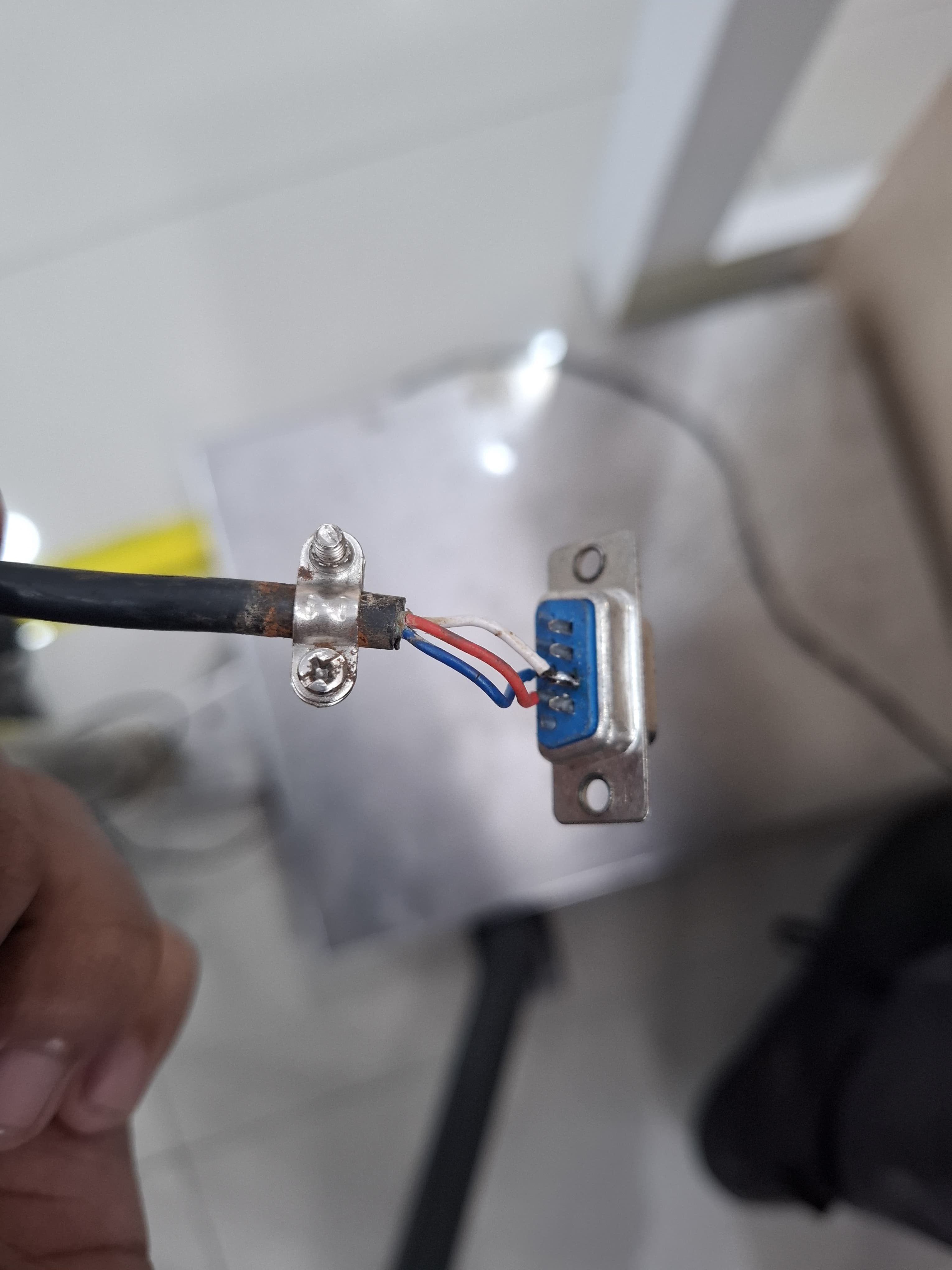

Is there usually only 3 cables for RS232 on CAS CI-200CS digital scales? I tried to disassemble the DB9 connector belonging to the scale and there are only 3 connected to pins number 2, 3 and 7.
According to the CI200 Series owner's manual, pins 2, 3, and 7 are correct for the scale end of the cable. Pin 2 is Tx, 3 is Rx, and 7 is GND.
What type connector is on the other end of the cable?
For the other end I use MAX3232 with db9 female connector. Previously the digital scale db9 connector was damaged and replaced with a new one so I tried to see the wiring in the db9 connector and the results were as shown in the picture in post 15. What I know is that pin 7 on RS232 is used for RTS and GND is on pin 5, so I am a little confused whether the wiring above is correct or wrong. I am still a beginner in this RS232.
Look at pages 72 and 73 of the owner's manual, that shows the cable wiring.

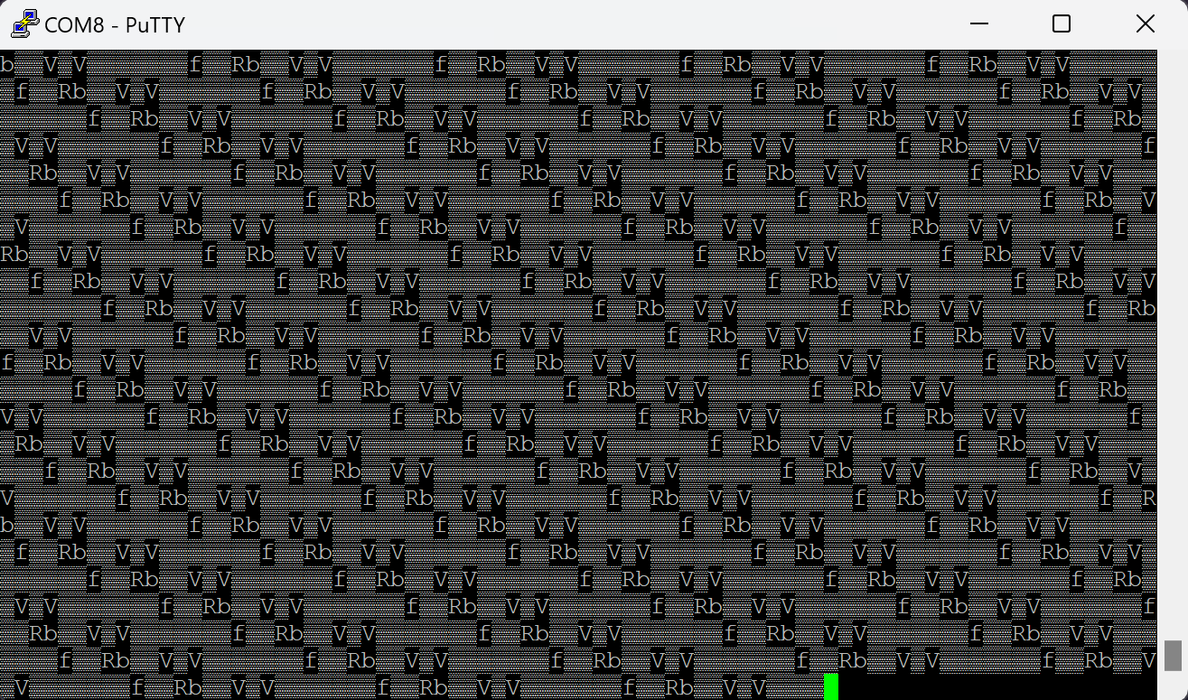

I tried with putty and connected the DB9 RS232 connector of the digital scale to RS232 to USB to the computer with the wiring as shown below.
but in putty it appears like this
how to solve it? did I make a mistake? I don't know how come the result of reading in putty is even like that
On the scale, pin 2 is Tx, pin 3 is Rx.
Are you certain of the settings for baud rate, number of data bits, and parity bit? There is definitely a pattern in the putty output, that appears to repeat in a 17-character sequence.
