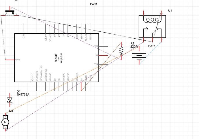

When I tried it, the relay stayed in the open state, not moving to the closed for some reason. I don't think it is a mechanical issue so I was wondering if I forgot to write anything in the code. Any suggestions?

Sure,
Here is a quick drawing, and a schematic I made using Fritizing.
Note:
  • I am using a 5VDC Relay, not a 12 like in the diagram
  • I only used a 330 ohm resistor, not a 220 like in the diagram
  • I am not actually powering a motor. This is to control a circuit I am building
  • I am actually using a 14.8V Lipo-battery
I am not sure whether I wired this correctly. Please help. Thanks,
Looks like you have no relay coil connection to +VCC.

A relay has two coil pins/terminals and three or more contact pins/terminals.

Relay - JZC-11F
5VDC
I think this is it :
12volt coil, it says the pickup voltage is 9 volts not 5 volts.
So is the 12V coil for a 5v relay, or 9v relay?
Looks like you have a 12v relay coil, it will pick at 9v.
This will not work at 5 volts.
Back to your diagram, even if this was a 5 volt relay, your drawing shows no connection to + 5volts.
Also what is the number on your transistor?
