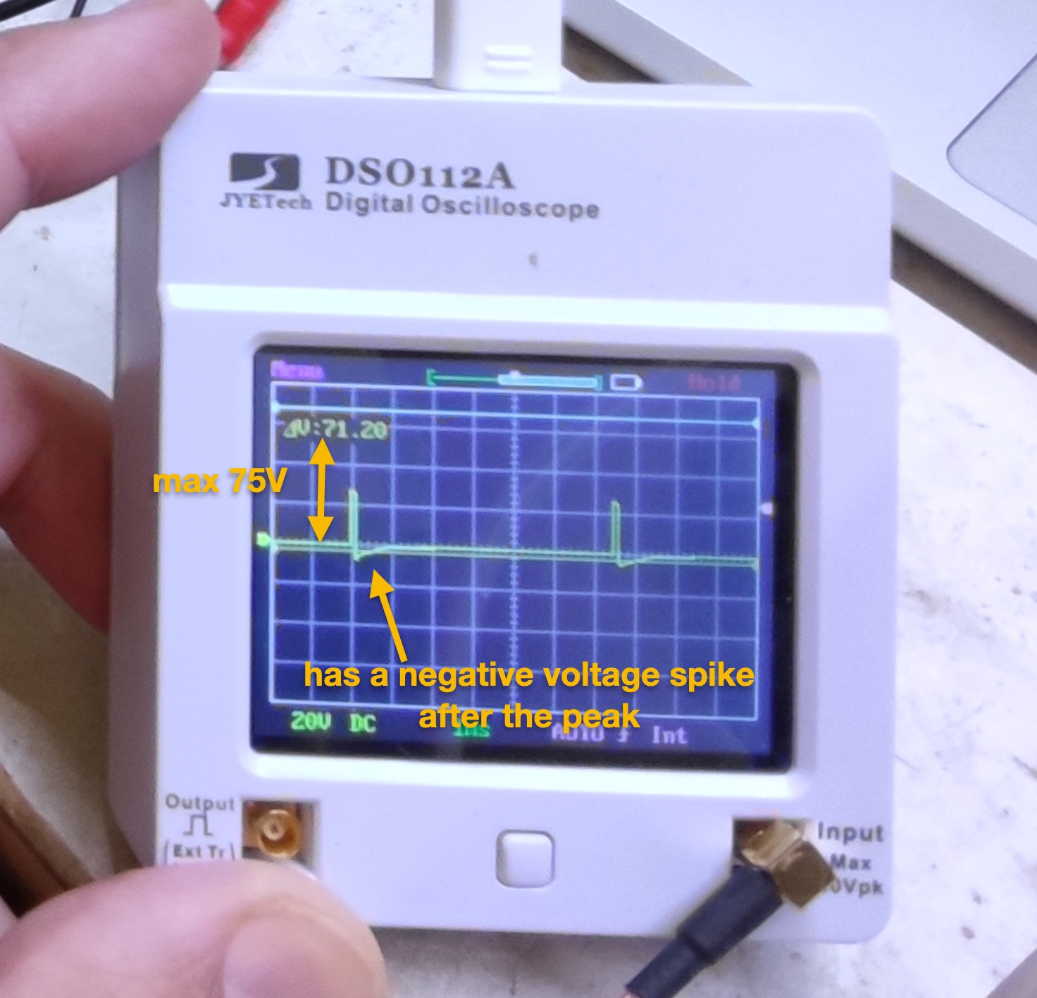

The device emits short pulses and those pulses have a high peak of at most ~75V followed by a short negative dip (see picture).

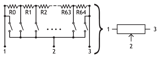

I haven't seen digital potentiometers that could handle 75V (@~80mA). The schematic of a digital potentiometer resistor network is quite easy to understand (see image below)
digital_resistor_ladder
I've been able to build a crude one with 9 steps and pushbuttons for the latches. Then I replaced the pushbuttons with an NPN transistor (S8050) as seen below but that didn't give me the desired result at all. I can't describe what the output is like, it just seems to be complete jumbled crap readings.
Can I not use a transistor as a switch in this particular case? This is yet again another proof that despite my best efforts, I don't seem to understand when a transistor can or cannot be used as a switch. The transistor blocks current but passes through the resistance regardless? I would very much like to prevent having to use big, heavy, clunky relays. Please advise!

This is probably what you might be after;
Q1 to Q3 are N-CH Logic Level MOSFETs, these will ensure low resistance switching.
R1 along with R2 and OR R3 and OR R4 will provide your potential divider.
With 3 switches you have 8 levels.
The MOSFETs must have a Vds voltage greater that the peak output of the Tens machine.
The gnd connections need to be there so the MOSFETs have the Arduino control signal and the Tens current as references.
I hope this helps, anyone feel free to suggest modifications, its off the top of my head at 11:00pm.

@TomGeorge: I tried your solution and no dice. The TENS signal appear to just bleed through the mosfets if they're open or not. I used three ILZ45N logic-level mosfets rated at 55V and 30A, and didn't crank the TENS device up high enough to exceed that voltage rating. See below my interpretation of your circuit (it helps me practise in KiCad too). I didn't have 470Ω resistors, used 1kΩ instead.
I was puzzled why the resistors were parallel to each other, wondered if it shouldn't be series, so I tried that as well, but no difference.
  • If the TENS "anode out" can go to 70V your MOSFETs need to be rated greater than this.
  • In this case Serial/Parallel would give similar results.
  • If the TENs "anode in" is not not limited to a maximum safe voltage you should add a resistor for when the MOSFETs are all OFF.
If the output control is left in tact in the Tens machine, then that will be limiting your max output.
What is the value of the pot in the Tens machine?
Probably 50K or so, your 680R will be too small, the Tens output circuit will possibly be a relatively high impedance.

@TomGeorge the circuit below works just fine with a regular dc voltage source though! I don't think transistors are meant to deal with AC signals (as the TENS signal does have an AC component to it. Plus the current leakage of mosfets is apparently "a thing"? Take this a grain of salt. At this point my mind had been filled with a ton of information and I can only extract partial wisdoms out of it :-/
Tonight I came across reed relays and those seem super promising regarding ease of use and small footprint. They can be directly driven by Arduino's 5V outputs, require 10ma to turn on, have an internal flyback diode, and the real kicker is they're rated at 200V at 500mA, fits so nicely into my 100V 80mA requirement. Mind you, I haven't received them yet but I'm hopeful at this point.

Although you may be right that 680Ω is too little per resistor for a high impedance source, this turned out not to be the reason for not getting the signal through as desired.
I have since received a few mosfet relays (this one), which as I see it are internally like an optocoupler but with an n-channel and p-channel mosfet istead of an NPN transistor. Effectively it enables switching AC and DC sources, and this appears to have made the magic difference for me! The rating of 400V AC/DC at 140mA is also perfect for me. Lovely to have a small package which can handle higher voltages. With these mosfet relays I was finally able to 'dim' the signal of the TENS device.
