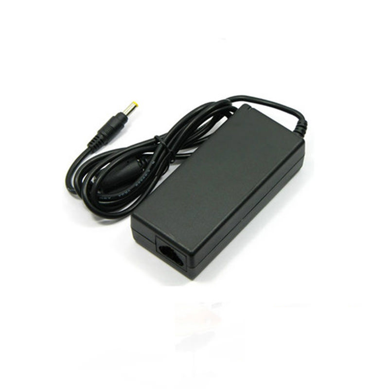

I've been looking a while on internet how to drop some voltage from a power supply and I found that
people say that you can drop some voltage using a single or more diodes in series. I have a 20~22V
4.7A power supply do you know what kind of diodes is better to use to drop down to/in between
12~15v ?
I used as a test 1N4007 3x of them in series and the voltage dropped to 19v is there any other kind
of diode that i can drop it more but with a single diode not more, does the diode gonna get hot? and does that gonna affect the Amps?

I need to power up a imax B6 80W (11v~18v), I got a 20~22V 4.7A power supply.

What you linked it's a really good idea and can be used in any kind of other projects, I already got a laptop power supply so it's 19v 4.7A (90W) but when i plug my voltmeter it says 22v that's why i wanted to drop the voltage.

Even if the PSU gonna drop I can't work with the iMax B6 because has a protection, when i plug the input PSU the imax start bipping and write "input voltage error" I can't do anything, pressing the buttons have only few sec effect then again start bipping. I need lower voltage

I found a solution using this module :
Yes, that will work (it's a switch mode step down converter as I suggested in my first post) but be aware the 3A out is the absolute max current (and probably isn't to happy to run @ 2A+ for long). So if you set the charger to charge to fast it will fry the converter. (Charger is speced @ 5A)
It's working really well, i start charging at 2A after 35min the module reached +85C` and start shuting down itself so i added a kinda big heatsink above and a 12v fun to cool down and works another thing is that the power supply start getting hot too so in the future if i will keep this setup i need to make a box to put them all inside. Power supply, drop down module, heatshik and fun. At least it's working.
