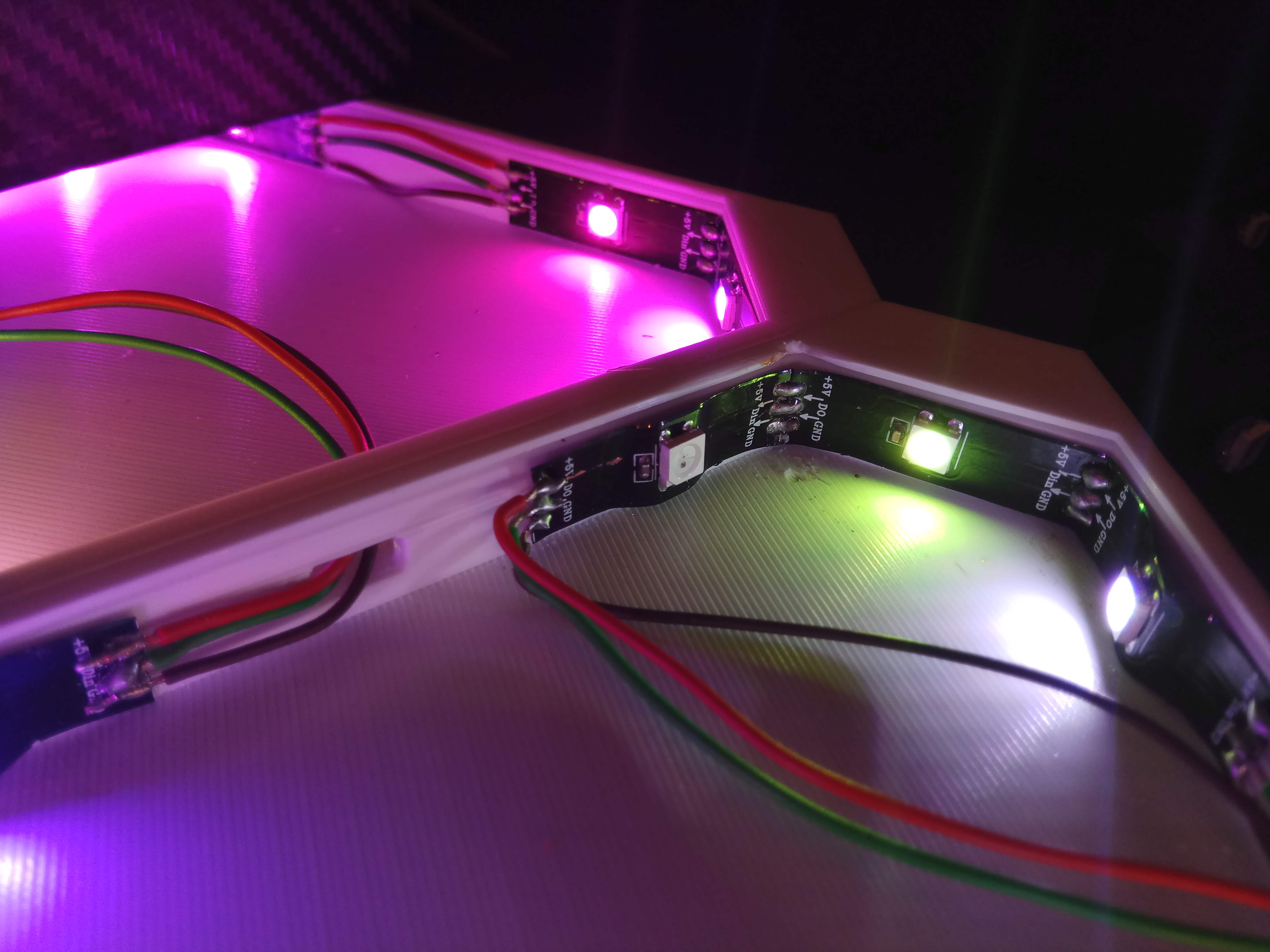

Here are two pictures of what is going on on the not working part.
The 2nd picture looks like there's a blob from the red to the green wire connected to that dark LED. And over on the left (can't tell if it's on or not), the solder looks unacceptable.
These things aren't tolerant of reverse voltage.
Between the Arduino data pin and the first LED in the string, I believe there is supposed to be a resistor (if you haven't done that). Going without can result problems.

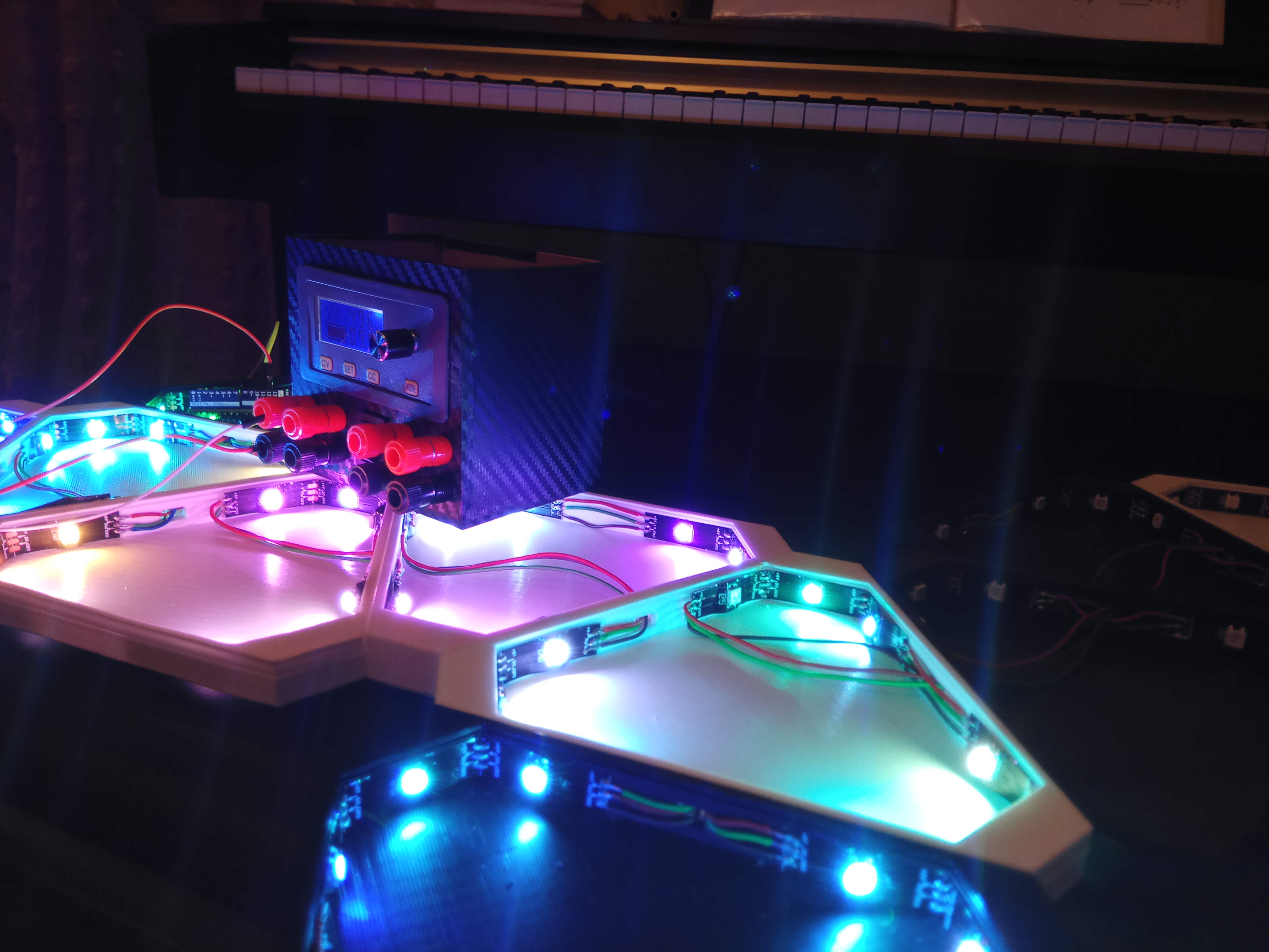

Ok, i got it working. Thanks a lot for your help, but now I have another problem. The data is reading is not right. Most times is flickering, some times the most leds are off and not the correct color. As I read from searching there must be a noise? I have a resistor between arduino's and strip's data pin. Should I open a new post?
Could be noise, could be poor connections (carefully check all your solder joints), could be programming issues.
