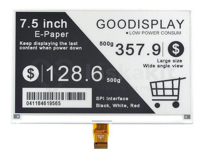

and this display
Display library used: GxEPD2_750_T7
GxEPD2_BW<GxEPD2_750_T7, GxEPD2_750_T7::HEIGHT> display(GxEPD2_750_T7(/CS=5/ SS, /DC=/17, /RST=/16, /BUSY=/4));
