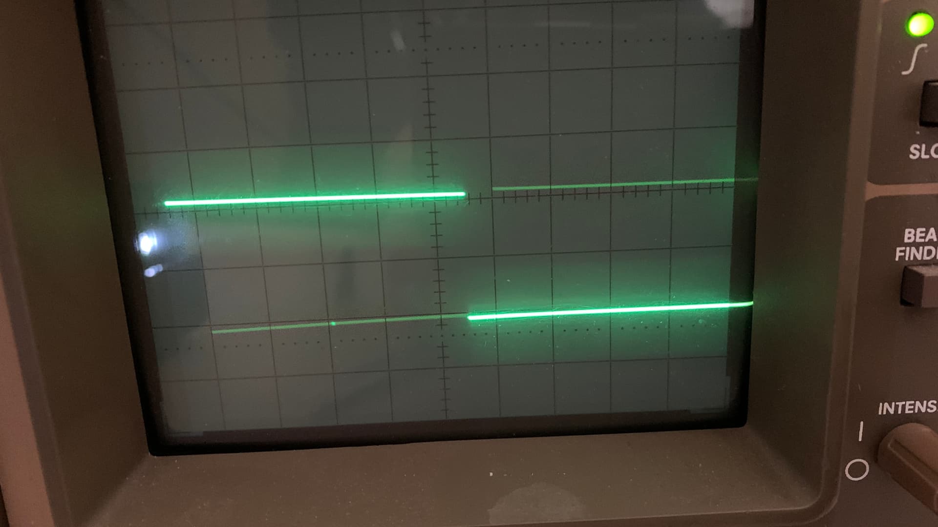

Hi Everyone!
I have a problem when using the TimerOne.h library on a Uno board.
The scetch include an adjustable pwm signal whith low frequency. It works but
for some reason the output is disturbed at various frequencies, see photos. I have removed all unnecessary code and added the basic code.
Replacing the Arduino board didn't matter.
What could be the cause of this?
Regards Wim

What are we supposed to learn from the scope plot?
Please describe the expected behavior of the output, and what it does instead.
Why do you initialize the timer, every pass through loop()? Something like that is usually done in setup().
There is only one photo and it doesn't clarify for me what you mean by "disturbed".

The scope shows a flickering in horizontal direction. You can see the little moving dot bottom left that disturb the signal. In the movie it's very clear...

Do you see this effect if you move the Timer1.initialize(t); to setup as suggested?
Do you see this effect if you are not adjusting the frequency or duty cycle?
Problem solved!!

I moved the Timer1.initilize(t) to setup as suggested and that was the solution.
Thanks all!
