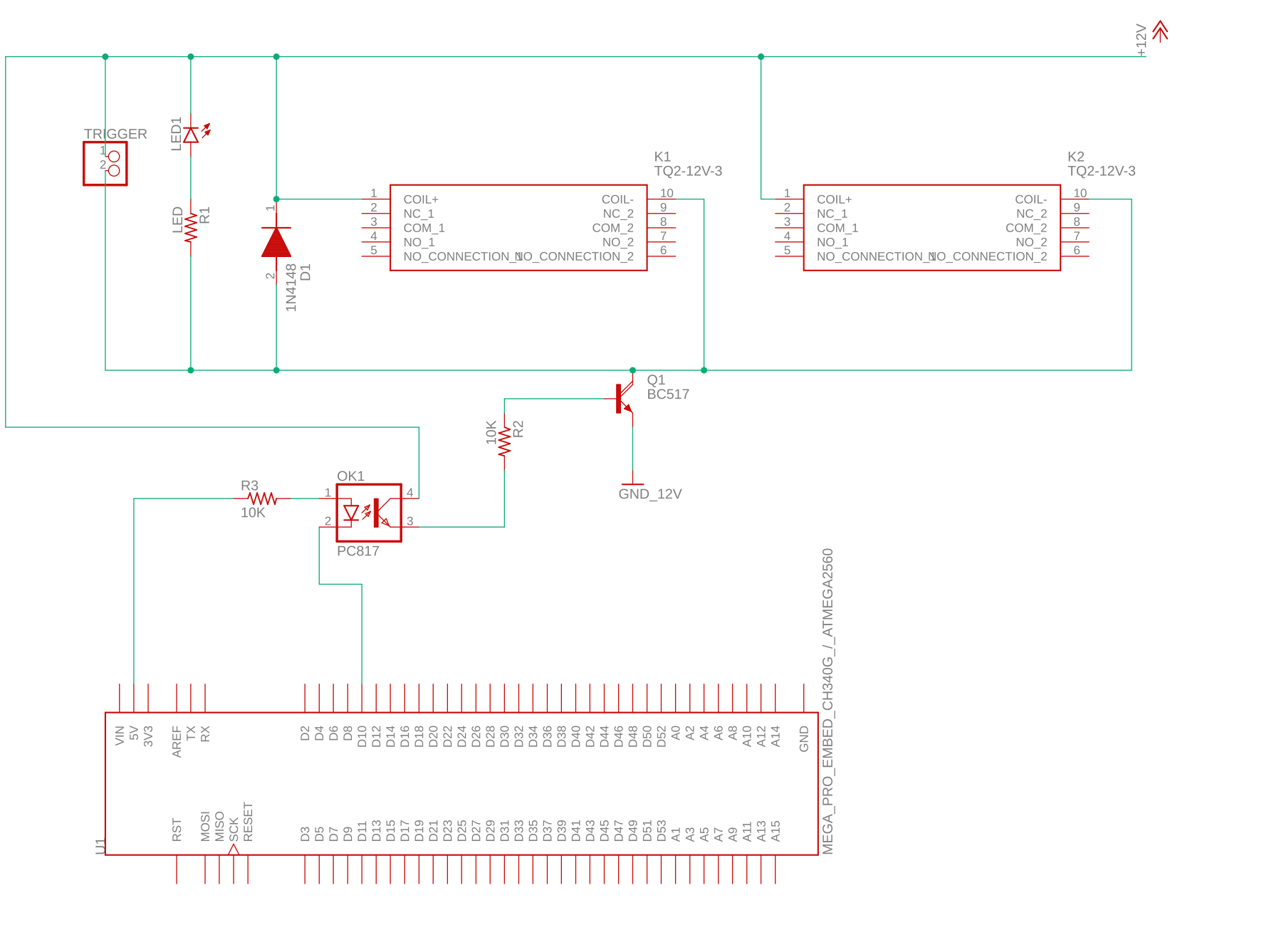

DIY 12V Relai schematics right?
Hi there,
I did not find anything 100% identical, gere in the forum.
I want to switch 12V Audio Relais on a DIY PCB with a Mega Pro.
Also the LED should light up and the trigger headder shall provide 12V DC up to 150mA.
Would this one work with these commands like the ready to go 12V modules?
int eightChanRelayIN1 = 11;
digitalWrite(eightChanRelayIN1, LOW);
(I know it is not a complete scetch.)
Also I'm a little unsure if I have any benefits from the PC817, since I just switch audio.
Will I go in any limitation with this, if I want to control much more of these, as long as I have digital pins and apowerfull 12V supply avalable?
Thanks and regards,
Felix
Add an additional diode across the coil of the second relay, just like the first one.
I expect it will work marginally as-is because OK1 requires significantly more drive. I suggest replacing the current resistor with something in the 300-ohm range.
Similarly, replace R2 with a resistor in the 1k range.
The transistor is a darlington, and the two relays are drawing 24mA total.
A 10k base resistor is good enough for that.
Why use a darlington. A BC547 would do.
For a BC547/8 the Ic:Ib ratio should be ~20:1 (10k could still work for 24mA).
Opto LED current should be twice the opto collector current (Google "opto ctr"), so 10k is too high. Calculate with Vf of the LED@1.2volt. 2k2 seems the right value for the LED.
You could omit the opto coupler if you can share the relay supply with Arduino ground.
Just connect the base resistor directly to the Arduino pin.
Leo..

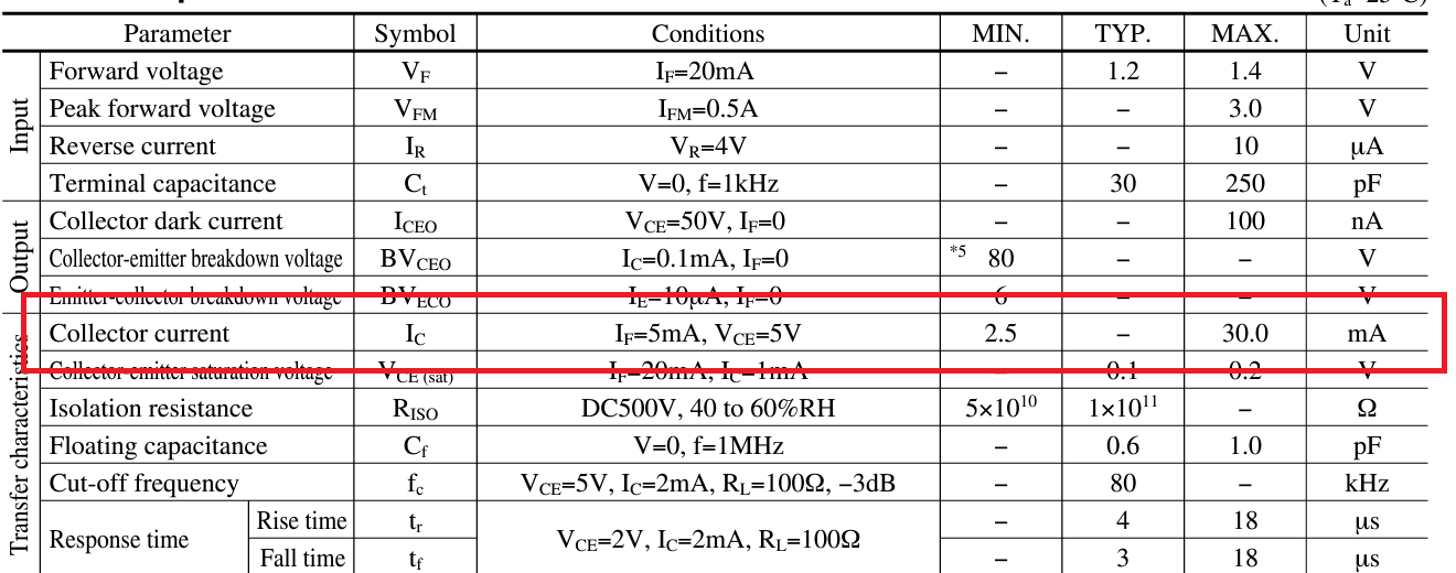

Hi, @Crix1990
The relay coil spec.
11.7mA is the current consumption.
The PC817;
30mA is the typical current it can switch.
So an LED running at 10mA, and these days 10mA LED is quite bright.
Why do you need the transistor.
Use the opto to drive the relay coil and LED.
11.7 + 10 = 20.2mA that's well below the opto rating.
You will still need the back EMF diode.
Just a suggestion.
If the CTR (current transfer ratio) of the opto coupler happens to be bad, then the opto LED could need twice the current of the opto transistor. To switch two relays (24mA), the required LED current could be 48mA. Too much for an Arduino pin.
One relay per opto, and an opto with high CTR would be ok.
Another thing to consider is the combined Arduino pin current for many relays (OP's requirement).
Leo..
I do not see the need, since the two couls are in parallel so the diode is already across both.
With the option that the trigger headder might grab up to 150mA (but might also be not even connected), I assume here a max consumption about 200mA.
Since I'm not that deep into the resistor calculation for these transistors, how do I need to size it with such a range of consumption?
Or would be really a MOSFET here the better choice?
Another way would be to not switch the trigger parallel with the relais, but with a 3rd relais.
With this the consumption on the transistor would be less and more constant, since the 3rd relais would switch, regardless if there is something connected to the trigger.
Also with this, the point to drive all through the opto itself is off the table.
Regards,
Felix
At 200mA a 2N2222 (BC337) has a saturation voltage of 0.1volt with a (minimum required) base current of 3mA. A BC517 darlington drops 0.8volt at that current, and dissipates 0.16watt, but only needs 0.2mA base current. A 2N7000 (no drive current) would drop 0.4volt. A BC547 is a poor choice for 200mA. They all will do the job. Your choice.
Leo..

So I tried to digg a little deeper into this.
You are right a BC337-40 should be the better choice (I just wonder why Mouser is so expensive on these, but anyhow, I have a German dealer here that has it for 4 Cents.
Since I want to make it switch about up to 200mA the base resistor should be about 11k, put a little spare and the 10k fits.
My question is, will I have a problem with 10k if the load is just about 45mA (the two relais and the LED)?
Regarding the PC817, I found some comments that it is not a very good one, but I see them often in use with arduinos.
Is there a replacement I should keep in mind?
(I did not found much about that.)
About the resistor for the coupler, I end up with an optimum of about 190R (5V supply 1,2V for the LED with 20mA).
So I assume you ment 220R instead of 2k2?:sweat_smile:
So I end up with this:
What do you think?
Regards,
Felix
Not a problem. A base current of 5-10% of max expected collector current is common for switching. 3mA for 200mA is just the absolute minimum to fully saturate. See the saturation graph in the transistor's datasheet.
An opto coupler is a basic part. Don't worry too much about it.
If you do, then get the ones that have been selected for CTR.
The LED can also be in series with the base resistor, which saves parts and current.
I meant 2k2, before I knew you were going to switch 200mA.
220 ohm is 17mA through the opto LED, and good for almost 10mA opto transistor current.
Use 330 ohm, and call it a day.
Leo..
