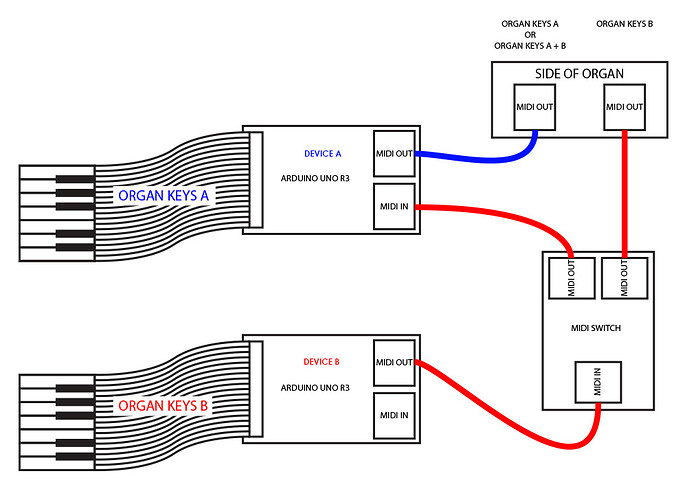

Hi Mike, I realise it's probably an odd way of going about it, but the idea is that this organ has 2 rows of keys which I would like to act as 2 separate MIDI devices and then by flipping a passive MIDI switch, have them act as one large keyboard. (attached concept)
I did have it almost working by pasting in fragments of other peoples code (I know, don't mess with it if you don't understand it) but I was hoping maybe this was something somebody had done before and had some well written, non-slapped-together code for.
So you're saying it would be better to have Device A and B both going into a dedicated merger (Mega) rather than trying to merge the internal messages of A with the external serial messages of B?
No, and nothing like the diagram you posted.
The diagram was my original plan. To have the 2 organ keyboards as 2 separate sources of MIDI.
The ability to plug the lower keyboard into say a small synth and the upper keyboard into maybe a MIDI to CV converter, but then also be able to flip the switch and have the lower keyboard run into, and then merge with the messages from the upper keyboard.

Well as you have the need for only one input and one output you can do this with with just a single MIDI interface.
but I have no idea how to implement that function myself being a complete beginner
You start by simply writing code that looks at the input and transfers any MIDI message you find to the output. Then simply add your keyboard scan and MIDI message generator to that.
