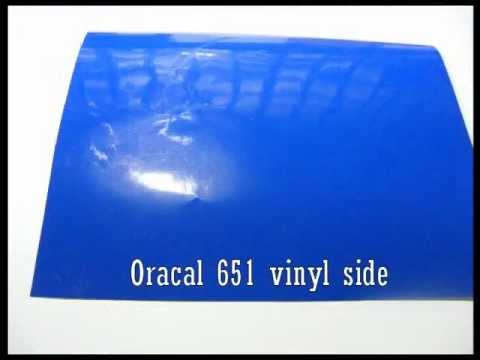

There two ways to use the vinyl . First one you buy a $400.00 dollar cutter. http://www.instructables.com/id/Fast-and-Easy-PCB-Prototyping-with-Vinyl/
And the one tho OP is taking about the vinyl paper that keeps it from sicking you remove it print on it place the vinyl back on and iron it peel the vinyl place on copper and iron it on then just peel it off and etch. I been looking for the second way can't find the link. http://en.electroni-city.com/
Found a video
http://www.youtube.com/watch?feature=player_embedded&v=FtmJdCBjwXY
and supplies to get http://www.ebay.com/sch/i.html?_nkw=oracal+651+vinyl+roll&_sacat=0&_odkw=oracal+651+vinyl&_osacat=0&_from=R40

Link is good. Thanks for that. No, the substrate that the manufacturer uses to carry the vinyl is not what is printed on. It's the vinyl that is printed on. Once it is printed it is placed onto the board, print side down, and the toner is then transferred to the board using pressure and heat.

Thanks for the video link vasquo, that helps very much to make the process understood.
