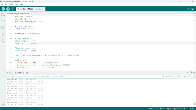

I’m working on a DIY Star Tracker project and have run into a problem. After uploading my sketch to the Arduino via the IDE, the Serial Monitor always shows:
Current AZ : 00.00
Current EL : 90.00
Current AZ : 00.00
Current EL : 90.00
This output never changes—even when I send a new command in the Serial Monitor. For example, if I type AZ:080EL:075, the monitor still displays:
Current AZ : 00.00
Current EL : 90.00
Current AZ : 00.00
Current EL : 90.00
I’m fairly new to Arduino—could anyone help me figure out what’s going wrong?
Here’s the code I’m using:

Please post the wiring, the schematics.
But your code does not read from the serial monitor. That would explain why it does not work.
It does seem to read something from the ESP8266
Because your profile is hidden, we don't know if you are a noob or not. I will assume you are given that you are not following the guidance re posting code.
Let me save you reading the pinned post re 'How to get the most from the forum'
You did post your code in code tags, that is good. Now post the serial log also in code tags.
As stated in post 2, post the hand drawn wiring diagram.
