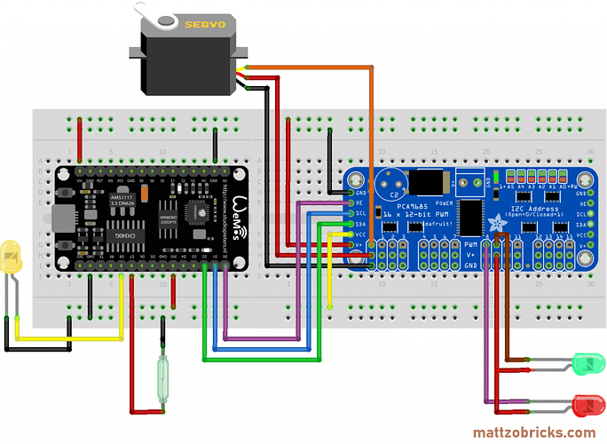

Hello,
I want to use a ESP8266 to control with pca9685 multiple Servos.
I use this setup: https://mattzobricks.com/wp-content/uploads/2021/12/Wiring-Diagram-MLC-with-PCA9685-0.4_Steckplatine-1024x748.png
When I use this example code everything works:

If I integrate the code into mine (see "void receive_packet()" In the area " if (DoCommand == "switch") {"), nothing happens. (Code from the example marked with "//vvTESTPROGRAM" and //^^TESTPROGRAM).
I control the ESP8266 with an app. For the lines "Serial.println(servonum);" something is also displayed in the serial monitor.
Does somebody has any idea?

It's not good. I see 3 LEDs with no current limiting resistors. I see a servo motor powered from the Arduino. Do you have a better setup you can use instead?
LEDs probably OK. The following is from Adafruit's PCA9685 tutorial.
They're set up for servos but you can use them for LEDs! Max current per pin is 25mA.
There are 220 ohm resistors in series with all PWM Pins and the output logic is the same as VCC so keep that in mind if using LEDs.
Servo appears to be powered by 5V from the USB connector. Using a 5V 2-3A wall power brick should be ok. Using PC USB host port (5V max 0.5A) will not work so good even for 1 servo.
Ignore the LEDs and the reed in the example. I didn't use those. The rest as in the picture
I have also tried supplying the PCA externally with 5V. I doesn't work too.
The simple example (above) also works. So there should be some kind of reaction when I incorporate it into my code.

Hi Paul,
yes, everything was displayed.
I think I have a solution now. I powered the PCA9685 externally with 5V and powered the ESP8266 from the PCA via Vin. Now it seems to be working. Test some more.
OK, it works.
But something is strange: Regardless of the angle I set, I can hear the servo working quietly for a few more seconds before relaxing. Doesn't sound good somehow.
Maybe it's a faulty servo. Try another one.
Could be that the servo is going to an angle, overshooting, moving back, overshooting again in the other direction and so on until it finally settles.
OK, thank you
Solved it with that:
      pwm.setPWM(ServoNr, 0, pulseWidth(DoValue)); // DoValue = 0 or 180°
      delay(250);                 // kurz warten
      pwm.setPWM(ServoNr, 0, 0 ); // ausschalten
The servo goes with pwm.setPWM(ServoNr, 0, 0 ); back to the middle position and turnes off. I would like liver if it stayed in the min or max. But I think that's enough for my purposes.
