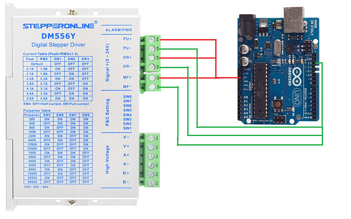

Can you please confirm to me this picture if its correct?
That looks fine.
V+ and V- is for the power supply. A an B, + and - are the stepper connections. A for one coil and B for the other coil.
Read the plate for SW1 to SW8 and set the swiches for current resp. type of stepping.
Thank you very much it is very clear for me now, but in some videos on youtube they connect DIR+, PUL+ and ENB+ to differents Pins in arduino isn't the correct way?

dich:
Yes, that's also possible. It does the same job. I prefer this way, connecting plusses to +5 because the low, the minus from the controller, is a little bit more reliable, more safe. Important is that the small output current flows the proper way through the opto diod.
Make the hardware run. Then proceed thinking about Grbl.
Ok, very fine i will connect them as you showed me.

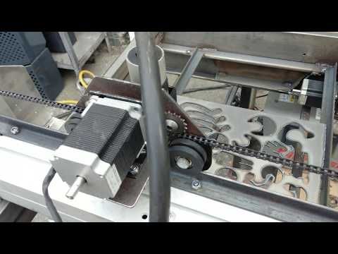

Dears,
Please i need your advise on this :
Check out the video from 9:30 to 11:30, is this thing will work for me (Hard wood and 5 to 10 mm aluminium), with the bike chain as transmission (see the image in attach).
This is the configuration that i want to go with, but o read some articles that they didn't appreciate the metal chain.
I think it will work for me but i need you expertise please.
Thank you
Looks like doable. What kind of objects will be handled? Weight, speed, stability demands, resolution, accurazy etc?

I want to work on the hard wood (beech wood), 10 mm thickness of aluminium or 5 mm.
the speed will not be a problem in the beginning however i need a good accuracy.
I have the feeling that if my machine could handled aluminium of 5mm thinkness it will capable to work on 10 or 20 mm (of course the cnc base should be solid enough to carry this kind of work). am i right?
Take a look at existing builds, rewievs of different ready kits.
Those square bars will not have much rigidity when the carriage is near the middle.
There are "tracks", looking almost like an up side down Y that can be bolted down along the entire length. Using the same construction but using ball bearings at 120 degrees instead of 90 is thinkable unless You buy that track together with a ready carriage.
Working in 5, or 10 aluminium might use hugher forces than one would guess.
