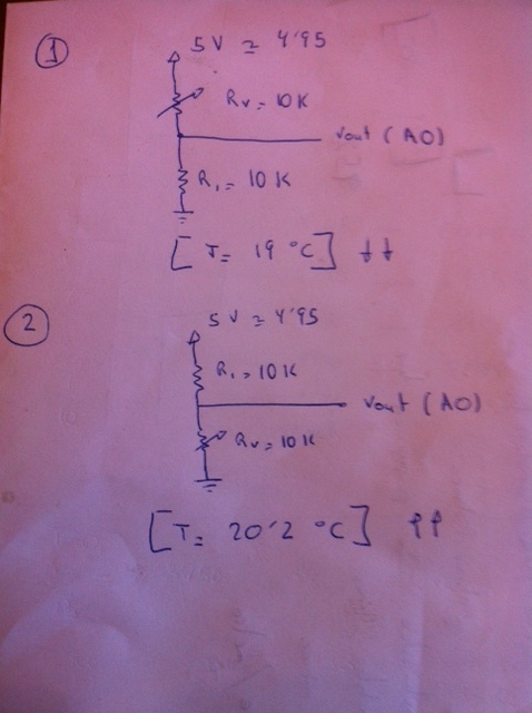

I took a photo with my phone hahaha and this is both circuit possibilities:
As you can see in the code i measured with a multimeter the different values of the different resistances and i added to the code.
In the first circuit shown in the photo, i measure 19ºC inside a room and as i said before if i touch with my finger the sensor the temperature displays in the monitor serial decrease.
In the second circuit, i measure about 20ºC and the value increase if I heat the resistance(logical behavior).
The second drawing would be the correct circuit but the thing is that I think inside this room would be at least 23 degrees, so i don´t understand these discrepancies
There are several things wrong in the code
  • float vin=5.03; // while you measured 4.95
  • float T25=293.15;//Temperatura kelvin a 25 grados
    This is the temperature at 20C not 25C
applying the T25 error in - Rinf=R25 * exp(-beta/T25); - this formula gives a substantial error ==> 0.0118 vs 0.0148 (20~25%)
Furthermore:
  • float T0=273;
  • float T100=373;
    missing 0.15 to keep them consistent, but OK this is a relative small error.
Have you verified these 2?
float RT0=23950; //Resistencia a 0ºC
float RT100=1433; //Resistencia a 100ªC
Check and fix all the values and measure again.
Solved!!!
Robtilaart thank you very much for helping me. The mistake was the temperature bad defined at 25º, i didn´t notice. Now the sensor measures about 25 degrees.
The voltage was bad in the drawing, the real voltage is 5.03 v.
Thanks again.
