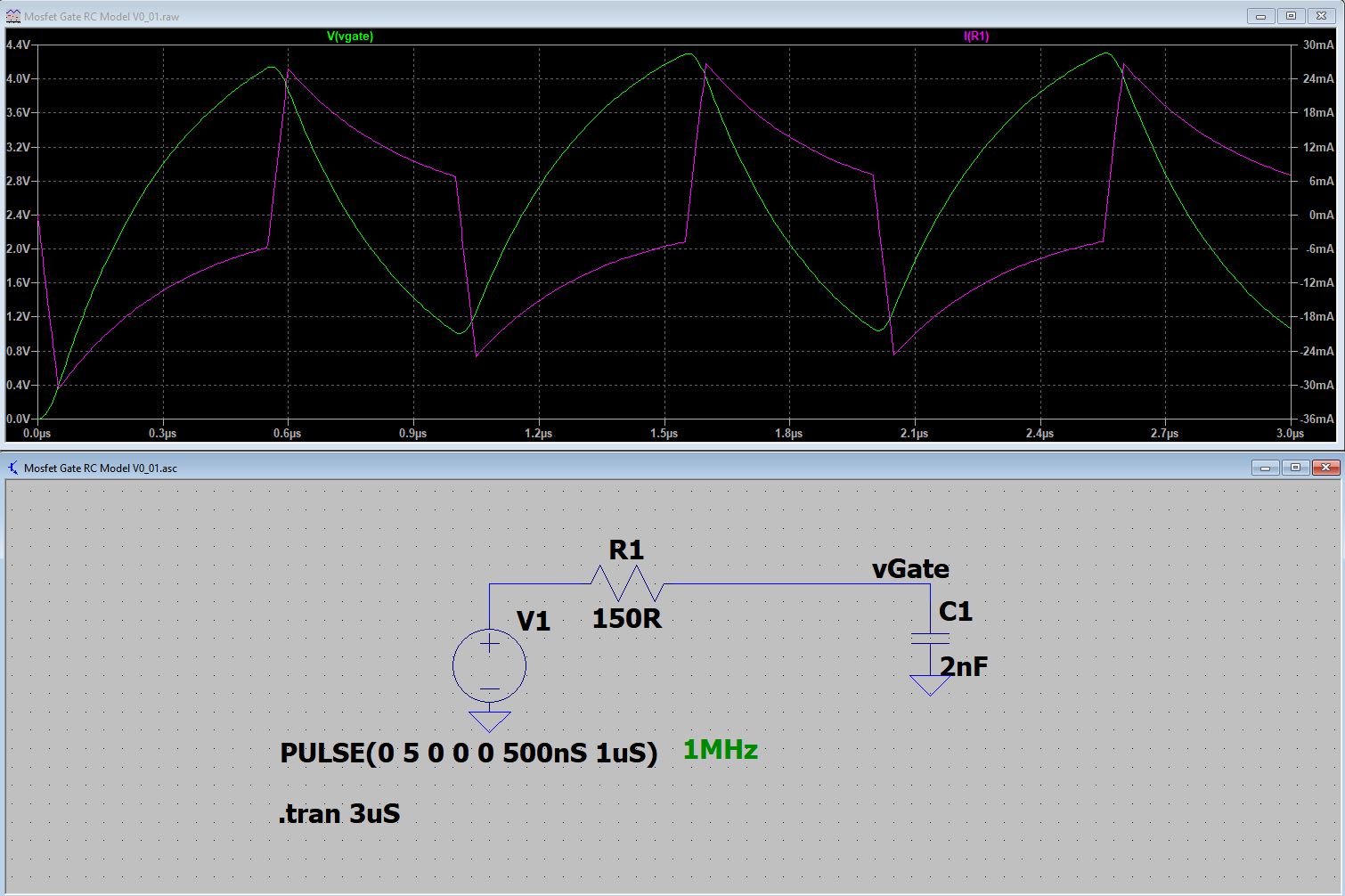

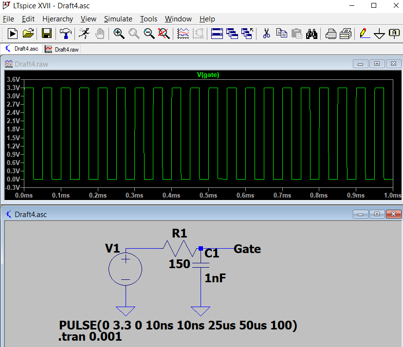

My approach would not be very scientific. I’d do a simulation in LTSPICE to model the RC network at that frequency and visually estimate, from the wave form, the the % of the time the mosfet would be only partially conducting.
If that looks OK, and the device is otherwise within the specified parameters, I’d simply do a test to see if the mosfet gets hot under the anticipated load conditions.

Simulation suggested by @6v6gt -> no need for a driver, provided that the pin can supply 22 mA.
Ooooh, this is the classic Nano category. I didn't know it has its own category. Sorry.
The Nano can blast 40mA into/from the gate. You could add extra hardware and strong drivers that can push/pull maybe 35mA. That would only be worse.
5V/40mA = 125 Ω.
So the suggested gate resistor of 150 Ω is perfect.

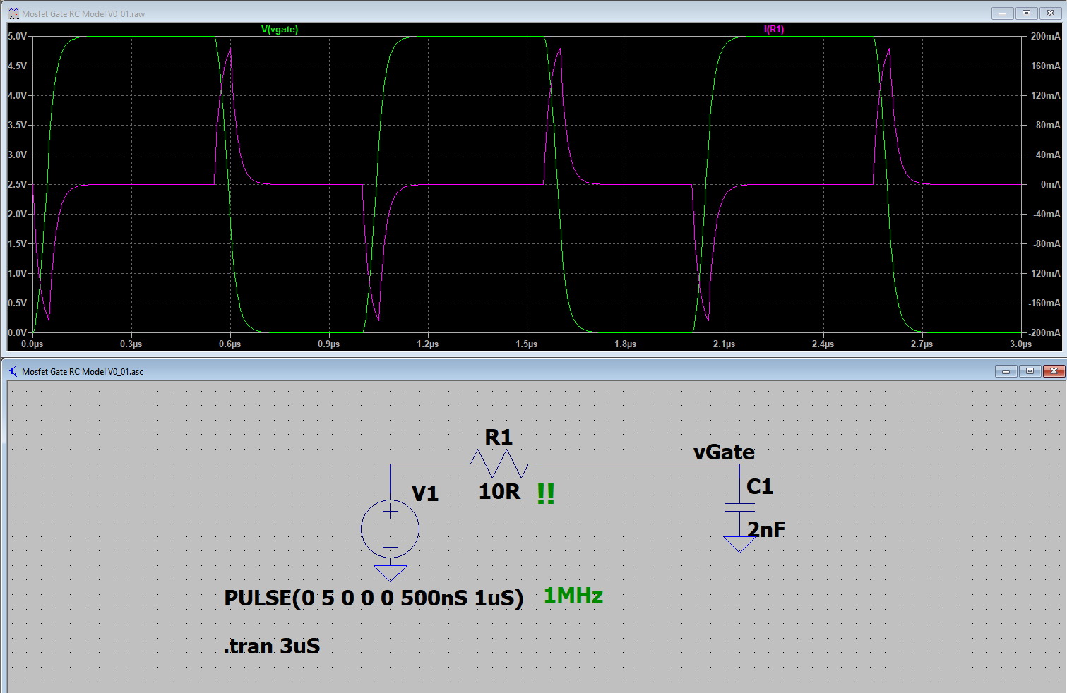

That looks quite conclusive. Out of curiosity, I repeated the experiment to see where it would break. That is where it is clear that an Arduino pin could not be used. At 1MHz and a gate capacitance of 2nF it looks quite grim and the Mosfet may not even switch off. Of course, this assumes that Pulse is a reasonable model of the Arduino pin.
With a Mosfet driver which can handle 200mA, the situation looks a lot better:
