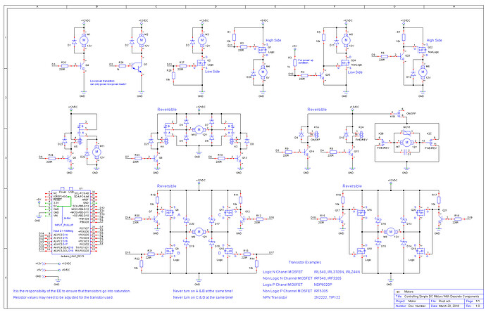

Greetings,
Once again the datasheets confused me because there is too much info for a beginner.
I might just be doing this wrong as well. (I know I am I should be using a driver chip... I just have so many 2N7000 Mosfets.)
I want to drive an 12V LED strip (~5amp, sizing for ~6amp) with an IRF520. Why an IRF520 because I was incorrectly under the impression it was logic level. (I realize now that at 5v i get 1 amp max.)
No biggie I have lots of 2N7000 as well so I thought it should be easy to daisy chain to get my Vgs up to 12V and get that sweet sweet power. I guess this is what a MOSFET driver would do but probably better?
Now I am confused.
1.) Should I voltage divide Vgs for the IRF520 to limit my current in case of a short?
2.) What is an appropriate current for the 2N7000 to drive a IRF520? Capacitance equations?
I don't know if this is similar to a pull up resistor that 1k range because at 100K range noise and speed is going to affect operation. Worse case I will just try things. :slight_smile:
3.) Also if I am putting out 10watts of heat what size of heatsink at room temperature.
Is there some sort of heatsink rule of thumb guide? Or is common practice to try it if it gets to hot make it bigger? :smiley: Also the 0.27Ohms holds for 100% on as well as duty cycle if i can soak the heat correct?
4.) For the 2N7000 i dont need a current limiting resistor since its voltage based correct? I just need to pull down or up as applicable.

In order to turn on a MOSFET, the voltage on the gate must be higher than the voltage on the source by a certain amount. To be safe when using a non-logic-level MOSFET, that voltage difference should be about 10V.
Use those two facts to explain to us why the posted circuit won't work.
Well when you put it that way... sounds like I asked what octane of gas is better for putting out a fire. :smiley:
So I have faulty assumptions . I want 12v at the IRF520 gate but if that occurs the 2N7000 source is now at 12v and then the Vgs is -7volts so the transistor cannot open.
Is this what is called latching?
I did my analysis when the thinking the 2N7000 was closed and could open then ignored the change in states when it opens. If I put the 2N7000 after the voltage divider, it doesn't mater because whether its on or off the voltage is always 12v if the PSU can source the current.
Also if i used a p-type mosfet then I would not be able to pull the voltage up enough to full switch off reverse problem. Since my Vgs = (-12 to -7) and my Vds is -12.
I guess to use only mosfets you would have to build it like a logic gate, with a P and N type on either side of the IRF520. Similar to a CMOS gate? Or am i way off base and a MOSFET pair is not like a CMOS gate.

Maybe it’s because it is late here, but I don’t understand what the problem is.
Here is a cheat sheet that might be of some interest.
The motor can be replaced with the LED strip.

Correct - that's one of the reasons we don't normally use p-mosfets in this kind of circuits.
Now you have two options: replace either MOSFET by a resistor.
The easy way is to replace the BS250 pMOS by a pull-up resistor to 12V. That way the moment you switch off the 2N7000, the gate of the IRF540 is pulled up to 12V and it switches on.
You can in fact also replace the 2N7000 by a pull-down resistor. Then you also need a unconventional power supply arrangement: connect the +5 and +12V together; keep the ground side of the two separate. Now the positive rail becomes your reference - you may call this 0V, or GND, your original grounds become -5V and -12V respectively. This will work perfectly well, but it requires you to remember that what you call GND is arbitrary, and you can declare any potential your 0V reference. Also by convention most power supplies have the ground connected, rather than the positive side.

Then definitely don't use any of these setups. It's too slow, you're going to keep your MOSFETs too long in half-open state as the pull-up slowly discharges the gate, causing heat and a generally poor performance.
Use a logic level MOSFET so you can control them directly with the gate (use a gate resistor of at least 250Ω to limit current to 20 mA and a 10k or so pull-down to ensure the MOSFET remains off while the Arduino starts up). For big MOSFETs driving big loads you need a gate driver (and then you may consider using a regular MOSFET, as those drivers will have no problem bringing the gate to 12V).

Those times are WAY, WAY longer, especially with your circuit.
Look at the gate charge of the thing: the total is about 94 nC. You can crudely approximate this as a 94 nF capacitor. To switch on the MOSFET, the gate voltage has to rise to >8V. You do this by charging the gate (that 94 nF cap) by a 12V supply through a 10k resistor. That makes switching it on about 1 ms.
There is a lot more to this calculation if you want to do it properly; but this is good enough for an indication of how long it takes to switch on. I think it's obvious what will happen when you try to do a 500 Hz PWM on this thing... about 500 ms per second it's in the process of switching on, regardless of your duty cycle.
Switching off is much faster as that's done by switching on the small N-MOSFET, so you're pretty much shorting the gate to GND. It may conduct 500 mA peak or even more (see datasheets for the limits here - things like the gate resistance of the IRF540 come in play here as well), for a pretty fast turn off.
On the other hand take the IRL540. Its gate charge is a bit less at 64 nC, so let's call that a 64 nF cap. This can be charged from an Arduino pin with a 250 Ohm resistor to limit the current to 20 mA. It'll be on at 4V, you charge at 5V, now the time to switch it on is about 26 us. Almost two orders of magnitude faster. Switching off will take about the same time. That will do quite nicely.

So my quiz to myself:
Not that I would do this but I think i understand the schematic to drive a mosfet with just transistors looking at the gate drivers.
In the below schematic:
Pin is ON (pull up default) then - Q1 and Q4 are on, therefore Q3 is off and Q2 the mosfet has no charge and is drained by Q4 so Load is off.
Pin is OFF then - Q1 and Q4 are off and Q3 is on therefore the Q2 mosfet gate is charging 12V at peak amperage of 5V/1.2k*20hfe = 0.083A into the Q2 gate and Load is turning on.
Using Qtotal as estimate Switching time = 16.0nC/0.083A = 100ns or 3% PWM period. +60ns for feeder transistors.
Do i get it enough to be dangerous? :slight_smile:
As stated before real gate drivers can source amps of current and can switch in the 100s of kHz with built in safety features.

Absolutely. Q3 being an NPN type with 5V at the base will not allow the gate to even reach 5V. That should open the MOSFET a bit, with high resistance, high losses, high heat and possibly smoke and fire.
To get the gate high enough Q3 has to be a PNP type, and that again makes it hard to switch off. Furthermore, a PNP and an NPN with the bases connected like that will switch each other on, resulting in a short, and moments later they'll die in a puff of smoke.
Seriously, just get a gate driver or get a logic level MOSFET.
The latest schematic has exactly the same problem (with Q3) as the very first schematic (with the 2N7000) in this thread.
For some reason, you aren't taking these lessons seriously.
