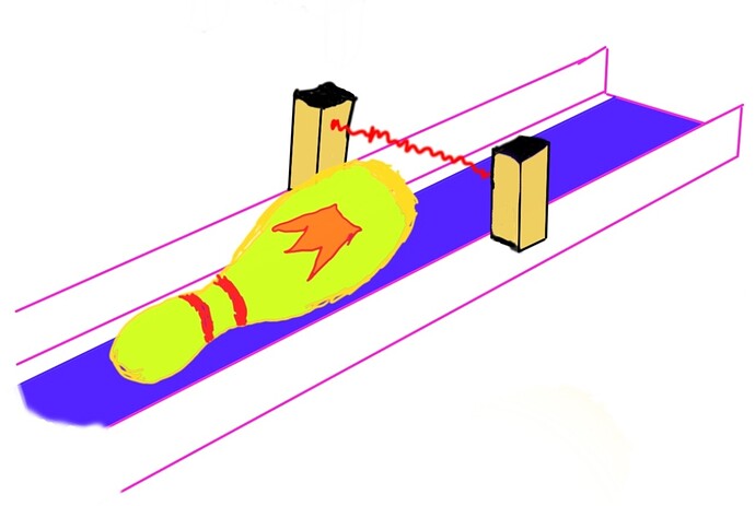

Hi all will give all of the big picture. Please see the attached.
This is the controll circuit of a 1960's vintage bowling pin spotter.
When PR1 is energized pins will feed to the table spotting cups. The pins pass by a mechanical switch counter (sw5), indexing 1 to 9 keeping PR1 energized until the 10th pin is fed, then PR1 deenergizes.
The switch (sw5) is physically about 6ft of away connected by 2 wires and the machine frame (ground).
The system is very mechanical and every so often will miss a count, so will feed 11 pins. The machine will now require the attendant to reset the machine. This can take up to 5 minutes or longer. Working counters are getting harder to find.
So my thought is to replace the mechanical counter with an IR break beam sensor, and a mechanical relay.

Holy cow, what a setup. So the schematic must be for the whole bowling alley. The video really helps to clarify what's going on.
This looks like an ideal setup for an electronic solution. There is a nice big bracket on which to mount a detector, or an emitter-detector pair (and there are several detection technologies to choose from). You will need something to convert the pulse from the sensor into something usable, and also to ensure that one and only one pulse is produced per pin. It might actually be better to detect the movement of the existing switch arm than the pin itself. Then you will need to count the pulses and send an appropriate, compatible signal to the rest of the electrics. All of this is doable and would make for a really cool project. But there also some potential snags, so you'd want to retrofit only one or two lanes at first, and track them for a couple of weeks to make sure that the cure isn't worse than the disease.

I agree. The schematic shows most of 1 lane. There is a 6 level 11 step rotary contractor. In the particular chassis I have, these rotary steppers were replaced with a digital. There are still centers with stepper relays.. I have decided that it will be a thru beam IR connected to an Arduino, not sure which one at the end of the day. The minimum timing between pins is known, so getting accurate pin detect should be somewhat simple. There are quite a few power interuption related issues. For example if the feed is on pin 3 and the power is dropped because of the off spot switches, what happens on power up? A mechanical switch has no issues with memory.
