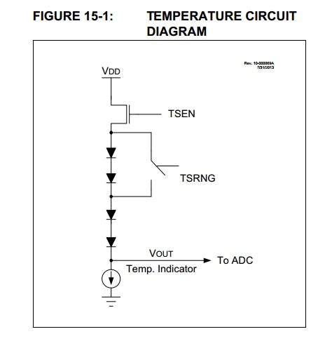

The datasheet doesn't say, but I'm pretty sure the temperature sensor is just a few diodes in series with a current source, like this diagram from a PIC datasheet:
That could lead into a discussion of what better ways might exist to measure temperature, such as an NTC resistor or a thermocouple.

Maybe the datasheet is not correct here. In my ATTiny85 datasheet the description of temperature sensor is a bit different:
The measured voltage has a linear relationship to the temperature as described in Table 17-2 The sensitivity is approximately 1 LSB/°C and the accuracy depends on the method of user calibration. Typically, the measurement accuracy after a single temperature calibration is ±10°C, assuming calibration at room temperature. Better accuracies are achieved by using two temperature points for calibration.
I think this holds for ATMega too. The ADCs are not identical (the Tiny has possibility of differential measuring) but the temp sensor itself is probably the same. So probaly you should callibrate at least at one point if you want somewhat accurate temperature (+/- 10 °C over the whole temperature range - but more accurate close to the callibrating temp).
Also if you are not interested in absolute value of the temperature but only relative change the sensor may be useful. For example quick increase may indicate something is wrong with cooling and you should turn off the load.
I'm not sure how accurate that is. How cold can canned air get when you turn it upside down and use it as freeze spray?
Using the equation Golam calculated from the datasheet function, I was able to get Frosty the Arduino's reported temperature to go from 85oC down to 7oC. Assuming the linearity is the same as the datasheet and it's just a matter of the offset voltage being different, an 80 degree delta from my normal ambient temperature would be equivalent to about -55oC with the freeze spray.
Apparently that's not as ridiculous as I originally thought, since I found a few pages that suggest freeze spray can go down to about -50oC in temperature.
Even if the datasheet is not accurate, as long as the output is consistent with respect to temperature, that can be fixed by characterising the output yourself. Measure the output of the sensor at 2 or 3 different temperatures without the range you are trying to measure.
The following is the response equation for binary temperature T in terms of ADC value (Post #6). (From the studies of Post #16, #17, and #18, we have understood that the temperature sensor of the ATmega328 is active, and we have decided to consider an 'unaccounted offset' of 500C for the temperature sensor at our own responsibility. Alternatively, we will re-calibrate (characterising the output) the temperature sensor using LM35 or a secondary calibrator.)
==> T*104= 2625h * ADCT - 27BE01h ---------------------(2)
