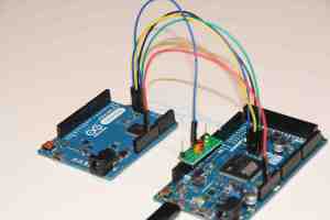

@Doc, I have the 1.5.x tiny cores, everything seems like the latest version. I gave up on the USBtinyISP and I went back to trying to use the Due as the ISP programmer.
I downloaded Peter VH's bitbanging ArduinoISP code and ran it as a sketch instead of the stock example ArduinoISP in the IDE.
http://forum.arduino.cc/index.php?topic=156764.0
It loads and gives an LED heartbeat. Progress.
You have to modify /hardware/arduino/avr/programmers.text:
#arduinoisp.protocol=stk500v1
arduinoisp.protocol=arduino
You have to be careful to keep all Vcc at 3V3, board and chip.
Switch over to Due Native USB port to upload sketch to ATTiNY.
More progress. I can now see SPI banging away on my newly arrived Saleae logic analyzer (an elegant tool). I have some wiring details to correct and then I am going to see if I can talk to the ATTINY in earnest.
I can now program the Attiny 4313 with the Due if I have the Attiny in a breadboard. It only fails about 5% of the trials. If I put the Attiny into a socket embedded into my local SPI bus, programming fails about 95% of the trials.
It does not seem to matter if I select the HARDWARE_SPI option of ArduinoISPdue or bit-banging. The SPI clock divisor is set at 225, so I don't know that I can go slower. At this point, I am having good enough success on the breadboard, but SPI programming seems real touchy when I try to integrate it into my PCB. I have checked all the traces for continuity, resistance, etc. On the logic analyzer, I can see the Attiny responding. The SPI signal levels look correct, but I keep getting device signature errors. It is as though SPI is so marginal that the traces and connectors on the PCB throw it off. The same circuit with the Mega worked fine. I will continue to see if I can isolate the problem.
I just tried it. This is a serious bug in the 1.5x IDE.
It requires a serial port before it even starts up avrdude even if avrdude is not going
to use a serial port.
This needs to be bugged.
It is serious enough that is should get fixed in the next release.
