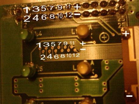

Thanks guys for your help, I am happy that the lcd controller is compatible with Arduino. I am now trying to figure out the pin connections.
In the picture below, you will see that i have found 12 pins + 2 for + and ground. I will have to figure out how to map these pins to pin identifiers such as D4, D7...
all tips are welcome.
And btw, nevermind the wrong numbering, i figured i made i mistake as soon as i uploaded the picture :stuck_out_tongue:
Image is updated

based on this DataSheet HTTP 301 This page has been moved for the LC7985NA lcd controller, i have mapped my pins to the controller pins like this:
V5 PIN1
RS PIN2
R/W PIN3
E(Enable) PIN4
DB0 PIN5
DB1 PIN6
DB2 PIN7
DB3 PIN8
DB4 PIN9
DB5 PIN10
DB6 PIN11
DB7 PIN12
Trying some of the LCD examples, my screen powers up, but nothing is displayed yet.
i am getting the test blocks on the first line now, but i can't get the lcd to display anything yet although i have wired the db4~db7 wires correctly.
Any tips?
Thanks

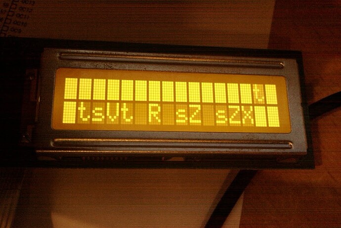

YAY!! I finally got the screen (half) working!! you can see a photo i have taken below.
I am using the LCD serialDisplay example, but for some reason, the caracters are getting corrupted.
in the example below, i have entered: this is a test
Any ideas?
Does anybody have an idea why my characters are displayed reverse and i am getting different characters than the ones i sent to my serial?
I though i had the wiring wrong, but i checked and doublechecked and it all looks ok.
did anybody see this before?
