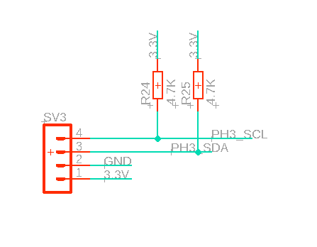

Post a schematic showing all connections and the pull up resistors and there value. Can you detect other devices on the I2C bus?
Here's the schematic. I tried using both the default i2c SCL and SDA and also used SERCOM2. Same issue in both cases. I do not have any other devices on the i2c bus.

Check whether the required pullup resistors are connected on the I2C bus lines.
This statement says you do not have the sensor connected correctly, especially the I2C pins. Confirm your connections and check again.

And yeah I have pull-up resistors connected to SDA and SCL.
