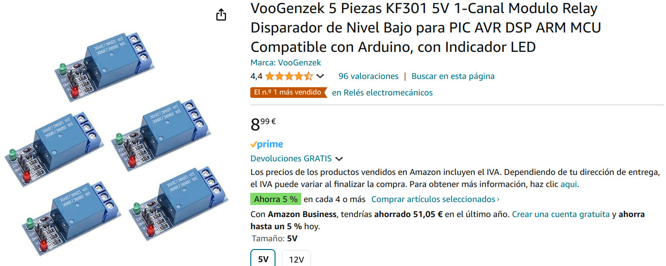

Does this relay switch have a flyback diode?
I bought these from Amazon:
How do I figure out if they have, or don't have, a flyback diode?
Would you expect it to have one? These are the same switch everybody sells -- they all look the same, they change the names each time...
I am experiencing random resets when I power a pump with it. I power the arduino and the pump with the same power (12V brought down to 5V with a buck converter, placed in the 5V pin in the arduino.
(I checked these very forums, and people mentioned that Arduino NANO is actually fine to be powered via this. However, I wonder if powering it from the Vin pin would help, although it would mean getting ANOTHER buck converter and step the power to 9V...)
The small part to the right of the green LED is the flyback diode.

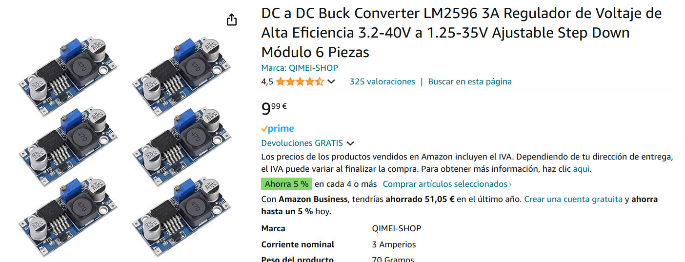

The power comes from this buck converter:
I use this to step down the power from 12V to 5V and feed the arduino.
So... when you say "bad wiring", what do you mean?

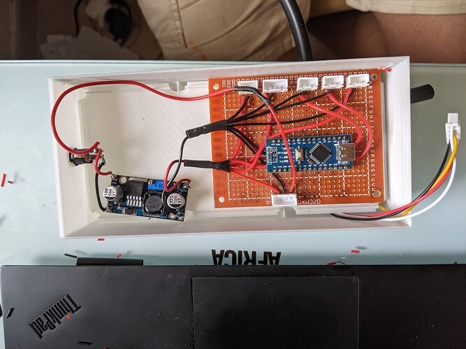

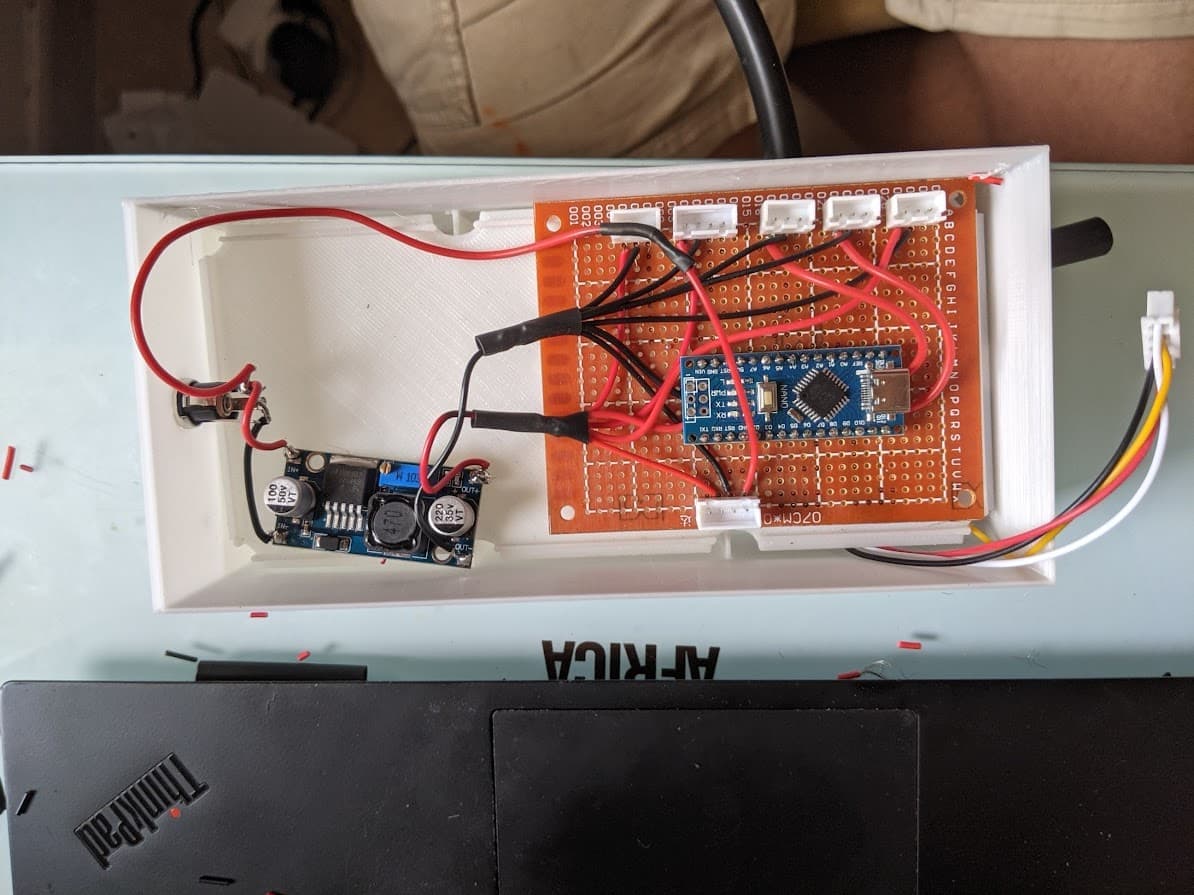

This is what my board looks like:
Sidenote: get a multimeter and use it if you do electronics
I HAVE a multimeter! What should I check?

I recommend a flyback diode and a 0.1uF cap on the pump and the solenoid as close as possible to the pump/solenoid
I will buy them... premium $$$ on Amazon...
I would effectively solder the diode and the capacitor to the across the terminals of the solenoid valve?
Like, across these:
Yes, same with pump.
Also, I don't recommend powering an Arduino via the 5V output pin.
If you want to power an Arduino via the 5V output pin, it must be well regulated, free of voltage spikes and noise.
I doubt if the buck converter with the pump load is well regulated and clean
