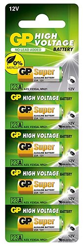

The link of the battery is: link battery
It is just defined as 23A.
You are right regarding the watts, I have just seen the label on the pump I have and it is different from the data in amazon, i.e 3.6W. I cannot find any Ah in the link I posted
23A is the battery type. It has nothing to do with the current (Amps) or capacity (Ah). A typical 23A-type battery has a capacity of around 35-40mA. It also has a maximum current of around 2mA constant. So it won't deliver 400mA but if it did it would only last for around 5 minutes before it was dead.

slipstick:
Now you see why we need links to the actual components.

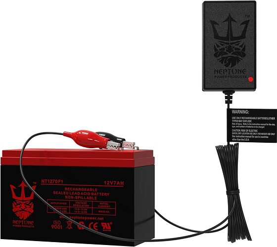

I have found this one in the link which would be good for me since I do not need to order online.
It is a
Sealed Lead Acid Battery 12V 2.3Ah
If the pump is using 400mA, with this battery I should have a capacity for 5 hours. Am I wrong?

Please note that the capacity of this lead/acid battery is hardly more than that of a pack of 8 AA alkaline cells or 3 LiPo 18650 rechargable batteries.

I have just purchased the battery I mentioned in the previous post. Hopefully, it would be fine. It is also rechargeable and it is just a little more expensive than purchasing 8 AA and a holder.
