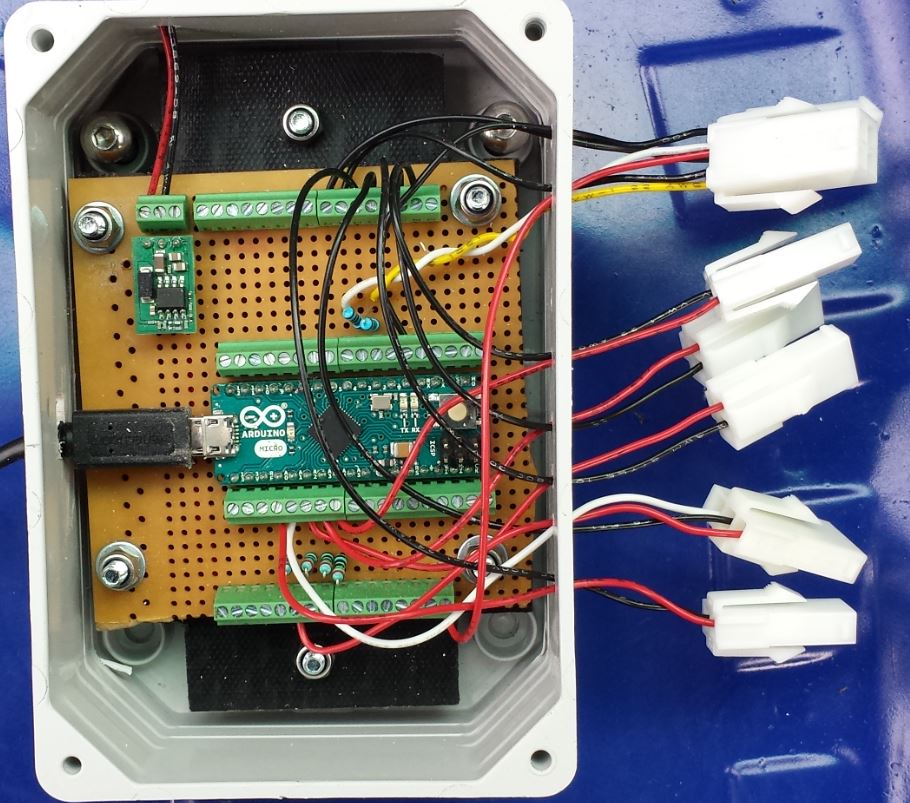

Does this relay wiring configuration adequately isolate Arduino? (JD-VCC Issue)
I do understand the JD-VCC issue and the principle of powering it from a different supply so that the Arduino is entirely isolated from the physical relay circuit but what I cannot quite get my head around is whether the configuration below achieves this or not.
System is based in a car. So circa 12V to 14V system, I use a 5V switching regulator linked a row of common +5V screw terminals and a row of common ground screw terminals. Arduino and all other sensors etc on the circuit are powered and grounded on these terminals so no power is drawn directly from the Arduino.
The current circuit is in use and works fine but the relay part of the diagram has not been installed yet.
If I connect from the +5V terminals to JD-VCC and the relay board ground to one of my ground terminals is this "separate" enough from the Arduino that it achieves isolation?
If I were to install an additional switching regulator for another +5V supply they would both eventually share the same ground anyway. I just can't picture how this works. Is the JD-VCC fix normally targeted at people who have connected the +5V and GND pins on the Arduino to the relay. So do all I need to achieve isolation is have ground not sink back via the Arduino so any stray current goes straight to ground rather than through the Arduino so a separate 5V supply are not actually required?

Its a racing car and the Arduino currently runs the dash display system. I am adding the relay to control the rear differential oil cooling pump automatically rather than manual flicking a switch like the current setup.
The below is updated to show how I was considering connecting it. 5V supply for both Arduino and the JD-VCC come from the common 5V rail but separately.
Arduino ground is not connection to the relay, the relay ground is connected to the common ground rail and the common ground rail is then grounded to an existing stud on the chassis that a number of other 12V systems already ground on.
My thinking is that as Arduino ground is not connected if there was to be an issued with 12V leaking in to the JD-VCC circuit it would go through the common ground rail and straight back to the battery. It would not cause the Arduino any issues. As the common ground rail is already grounded to a point shared with 12V systems (the external ground in the diagram) then this is effectively the same it is just connecting the grounds together a littler sooner. I could however run the relay ground down to the stud on its own and skip the common ground rail if needed.
Am I missing anything here?

I was going to wire it up yesterday but mention of reverse diodes, physical relay separation and shielded cable made me doubt I was doing things correctly!
Something that doesn't make sense to me yet still is the separate 5V supplies, whether we are talking about two different regulators or just 2 different wires from the same regulator. I am actually now a little confused as to what we are protecting here by separating VCC and JD-VCC.
Are we protecting against a failure within the relay that causes 12V to leak in to the JD-VCC side of the circuit OR are we protecting against some sort of voltage spikes/noise on the JD-VCC circuit caused by the coil? I assumed the diode on this board was there to prevent any issues the coil would cause so separation was only about keeping 12V away from the Arduino.
If that is the case then I just can't see why I would need two different 5V sources from different regulators. If 12V somehow found its way in to the JD-VCC circuit then it would surely want to continue to ground and so will just flow to the common ground rail then to external ground or directly to external ground if I decide to wire it direct there and skip the common rail. It wouldn't have any interaction with the Arduino as their is no path for it through the Arduino to the car battery?
This is effectively how the relay would be wired around the Arduino, in reality the 5V from regulator runs to a row of screw terminals which all supplies come off individually and similar the GND on the regulator runs to a row of screw terminals which all grounds go to individually. Added a photo of it as is to aid understanding.

What you have seems reasonable. The alternative, if absolutely necessary, is to use a DC-DC converter module with isolation betwen power and output.
My concern is switching a 12V 5A motor on and off. That's fundamentally different from the rest of your system.
With the battery mounted near the rear, it seems like a good thing to keep the circuit path of battery-relay-motor-ground as short as possible and away from the Arduino stuff.
When the relay OPENS, the motor will produce a voltage transient of 100 volts or more. I think you need some approach to absorb that. The usual approach, if the motor does not need to be reversed is to mount a diode oriented in the "reverse" direction, similar to the diode shown across the relay coil. I'm not quite sure how to size that diode, but I'd look for a 3A 400+ V rated silicon diode. [Anyone else know how to size that?]
You're right in that there will not be complete isolation with the circuit you show. Maybe it's not a problem. But I would personally want the relay close to the battery and motor. At least you can run a separate 5V wire to the relay board, physically separate from the main arduino, stuff.

So I think mainly in the interest of better safe than sorry and because I am not 100% I understand what I am doing in this situation I will add a separate 5V regulator and move the relay physically.
I will install the new 5V regulator and relay in an enclosure somewhere between the current Arduino and the pump and I will also run the ground from the regulator and relay to back nearer the pump and battery which is the opposite direction of the Arduino. That will shorten the path and keep it separate from the Arduino circuit as much as is possible. So the shortest and easiest path for any current grounding itself from the relay will be straight back to battery negative connected to the chassis.
I'm concerned about placing the relay right back at the pump for 2 reasons which I think are valid but you may correct me:
