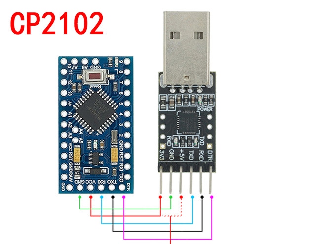

hello , please help me ,I cannot upload any sketches to the arduino Pro Mini

Hi @m82m107.
You mention a problem uploading sketches, but the output you shared is from a "Burn Bootloader" operation, not an upload.
We need information about the uploading problem in order to be able to effectively provide assistance. In some rare cases, upload problems can only be solved by performing a "Burn Bootloader", but this is a complex procedure that requires additional hardware so we only resort to that after we have eliminated the other more simple possible solutions, and only when the evidence indicates that the "Burn Bootloader" operation could fix the problem.
Please provide a detailed description of the hardware setup you use when you are attempting to upload sketches to the Pro Mini. Unlike other Arduino boards, the Pro Mini doesn't have an on-board USB interface so it is necessary to connect an external USB interface to the board in order to upload. So we need to know:
  • What exactly are you using as the external USB interface?
  • How is the USB interface connected to the Pro Mini board (we need to know the exact electrical connections between the two)

OK, great. That makes things more clear..
I'm going to ask you to provide the full verbose output from an upload attempt.
:exclamation: This procedure is not intended to solve the problem. The purpose is to gather more information.
Please do this:
  1. Select File > Preferences... (or Arduino IDE > Settings... for macOS users) from the Arduino IDE menus.
    The "Preferences" dialog will open.
  2. Uncheck the box next to Show verbose output during: compile in the "Preferences" dialog.
  3. Check the box next to Show verbose output during: ☐ upload.
  4. Click the "OK" button.
    The "Preferences" dialog will close.
  5. Connect the CP2102 module to your board.
  6. Connect the CP2102 module to your computer.
  7. Select the port of the CP2102 module from Arduino IDE's Tools > Port menu.
  8. Select Sketch > Upload from the Arduino IDE menus.
  9. Wait for the upload to fail.
  10. You will see an "Upload error: ..." notification at the bottom right corner of the Arduino IDE window. Click the "COPY ERROR MESSAGES" button on that notification.
  11. Open a forum reply here by clicking the "Reply" button.
  12. Click the <CODE/> icon on the post composer toolbar.
    This will add the forum's code block markup (```) to your reply to make sure the error messages are correctly formatted.
  13. Press the Ctrl+V keyboard shortcut (Command+V for macOS users).
    This will paste the error output from the upload into the code block.
  14. Move the cursor outside of the code block markup before you add any additional text to your reply.
  15. Click the "Reply" button to post the output.
