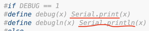

I found this tip by Kevin Bacon on youtube, It's a great tip. https://www.youtube.com/watch?v=--KxxMaiwSE&t=965s

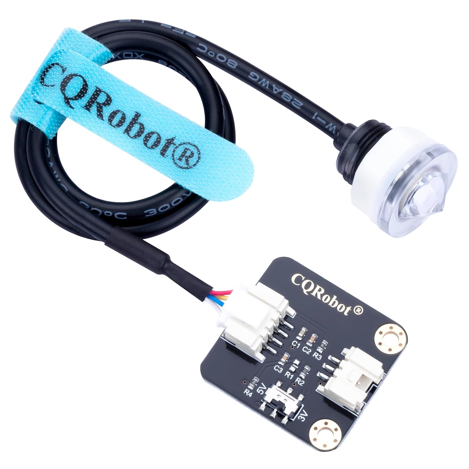

I added this tip to a simple state machine script, that I wrote, to turn on my sump pump via a tiny water sensor.
that I found on Amazon
My master sump pump is in the same sump pump hole "small hole diameter", as my second backup sump pump, and the big float that turns on the master sump pump would sometimes get hung up on the backup sump pump, and then the pump would run continuously. So to fix that issue I used a small water sensor to replace the huge floating ball.
It works great, I hope this helps someone

// DECLARATIONS
//Kevin Bacon Tip https://github.com/RalphBacon/224-Superior-Serial.print-statements/tree/main/Simple_Example
//This allows all debug statements to be switched on or off with one setting.
#define DEBUG 0 //all debug controlled here, set DEBUG 0 to DEBUG 1 to turn on debug, set DEBUG 1 to DEBUG 0 to turn off debug
#if DEBUG == 1
#define debug(x) Serial.print(x)
#define debugln(x) Serial.println(x)
#else
#define debug(x)
#define debugln(x)
#endif
